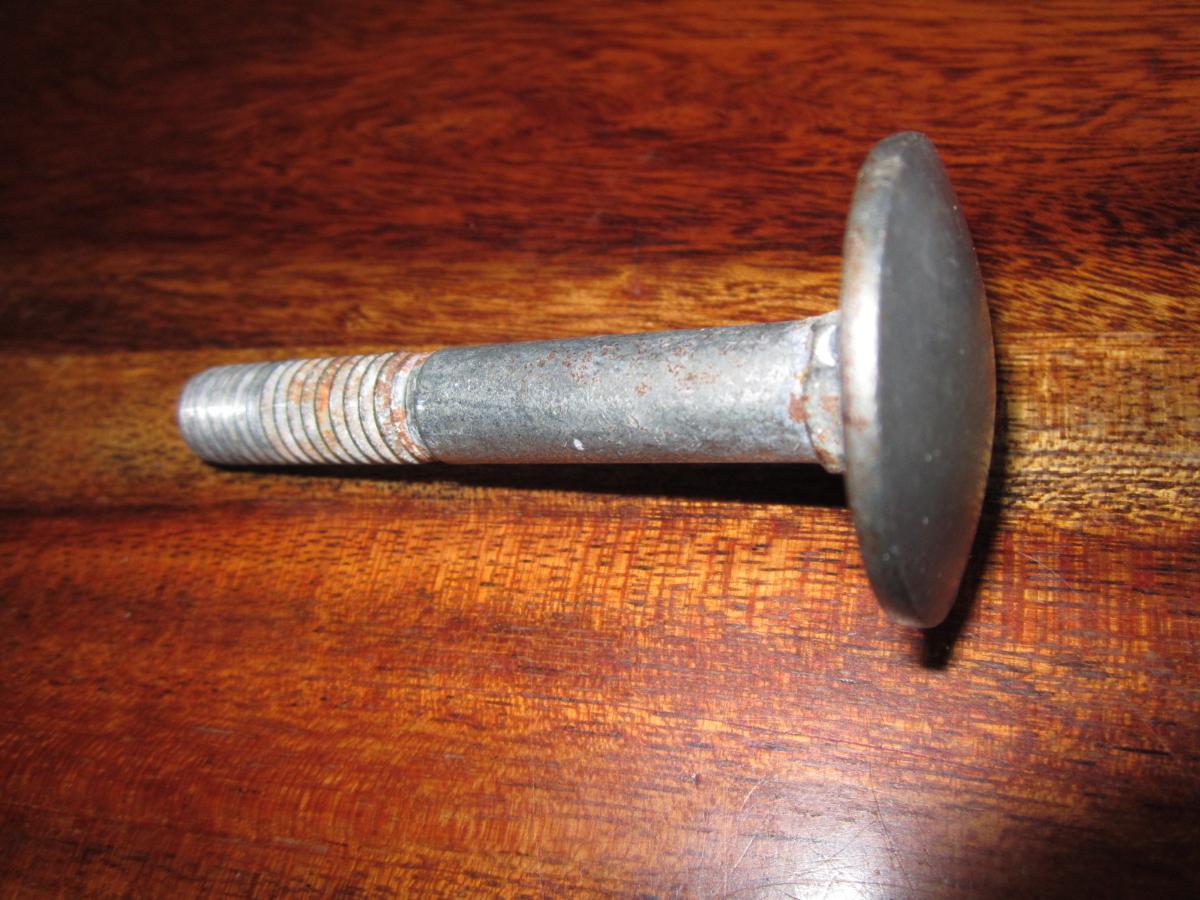

My 37 Sedan Delivery has some wood cross members in the rear quarter area that support a wood floor. Some of the cross members are held in place with special bolts. Not sure if they are called carriage bolts, elevator bolts or what.
Some of mine are broken/or badly rusted. Can someone suggest a supplier that might carry these. My go to person would have been Roy. Does Michael carry these? I could call him but thought it would be good to post here in case others have the same need.
The bolt in the photo is: 3/8"-16 x 2.5". I need a 3" one. The bolt head is ~ 1 3/16" diameter.

I believe that they are known as 'step bolts', distinct from carriage bolts because of the wider, flatter curvature of the head. Elevator bolts have a flat top and a slight countersink to the underside of the head.
Are you sure of the thread count? Period Ford floor bolts usually had fine threads, which are much more difficult to find these days. If you really want course thread bolts they should be readily available from fastener suppliers such as McMaster-Carr. If you want them with fine threads, that's a real challenge. Michael may have them or you could buy oversize course thread bolts, cut off the course threads, and cut new fine threads on the remaining shank of the bolt.

Ah, step bolts. I will search for those.
As long as I can find bolts with the large diameter head, I am ok with either fine or coarse threads. Looks like I have some options.

If the head is good cut bolt shank off and weld new section on.

McMaster-Carr has a very large selection of elevator bolts in many sizes. I know that's not exactly what you are looking for, but might help while you are searching for the correct bolts. They do show a slotted bolt that has a slight dome so you might be able to weld up the slot and finish it.

I just checked a catalog I have from Restoration Supply Company, www.restorationstuff.com. They list a bolt very similar to what you are looking for ,PN NUT373, but unfortunately it's only 2.5" the same as yours. You might give them a call and ask if their supplier can provide a 3" bolt. You might get lucky.
