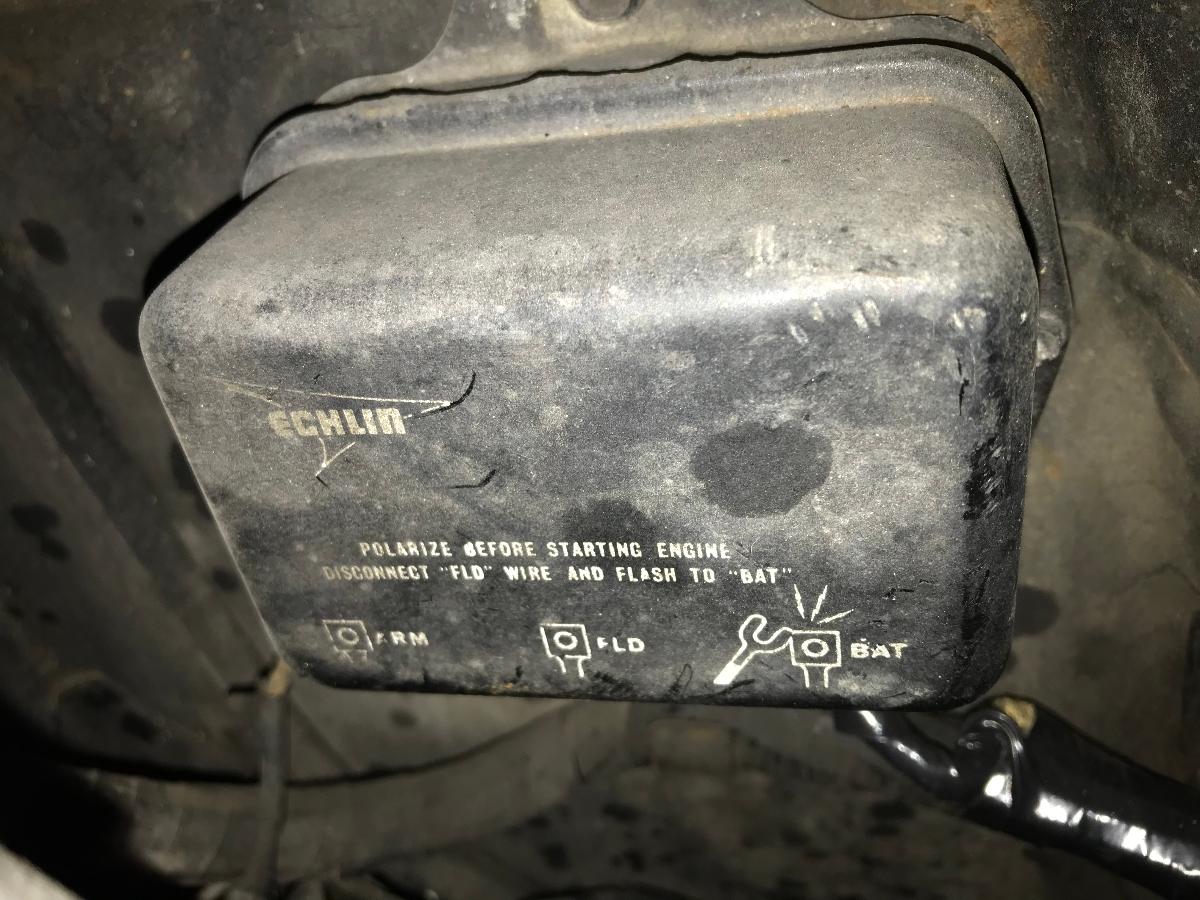

Looking for a good 6 v regulator for my ‘50 Ford. Have bought several. They are new but seem to be not calibrated: I have had the generator checked out a auto electric place and checked in the car by jumping field to arm on gen’r . Note: yes, I polarized regulator
Some history:
1. Engine off and 6.4 v across batt’y terminals
2. Start—6.2 v batt’y. 1.25v armature. .25v fld and dash ammeter needle stationary at midpoint
3.jump fld to arm engine running and 8.0v at batt’y and dash ammeter goes up to about 3/4.
4. Engine off and back to 6.4 v

01-26-2020 @ 8:57 AM
The voltage check needs to be made with engine speed around 1,200 RPM or at about 20mph.
Crank the starter with the ignition OFF for about 20 seconds to slightly discharge the battery. Connect your meter to the BAT terminal, start the engine and slowly increase the engine speed. You should see a slight drop in the voltage when the cutout picks. Keep increasing the engine speed while watching the meter, the voltage should increase up to 7.2 - 7.6 Volts. If it doesn't, take the new regulator back to the store or to the auto electric place and have them adjust it.
The regulator needs to be at operating temperature and checked with an accurate analog meter while being adjusted.
Many times the problem is not with the adjustment, but with corroded cutout contacts. I use a very fine (2,000) diamond file to burnish the points. The regulators have been sitting in warehouses or trailers for years and some surface corrosion will occur.

supereal
01-26-2020 @ 10:13 AM
Posts: 6819
Check to be sure that the regulator is firmly grounded. At one time there was a terminal on the unit for the purpose. It was then changed to a brass ferrule in one of the mounting holes, or a brass strip under the base. Without a good ground, regulators have erratic operation, or cease to work at all. Lots of good regulators were junked for this reason. Remove all paint or other substance under the mounting when installing.
