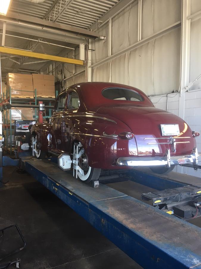

V8JR Lots of good ideas shown in the above comments. I got frustrated trying to check the toe in on my '46 Coupe using different methods, none of which I was happy with. I had just put a new set of tires on the car, because the tires that were on it when I bought the car were cracked on the sidewalls and the front ones were worn in a "scrubbed" manner. Wanting to make sure, I took the car to the local Ford dealer to do the alignment. The only problem was the specs. I gave the Tech was in inches, so he had to convert to degrees to get the number that would work in the alignment unit. Cost me $100 for the job.
