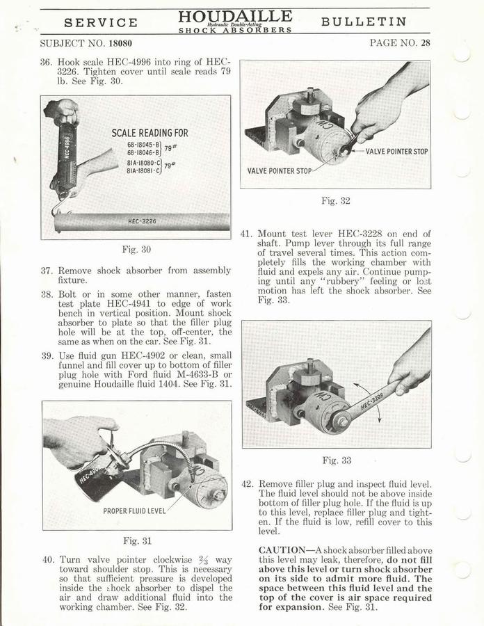

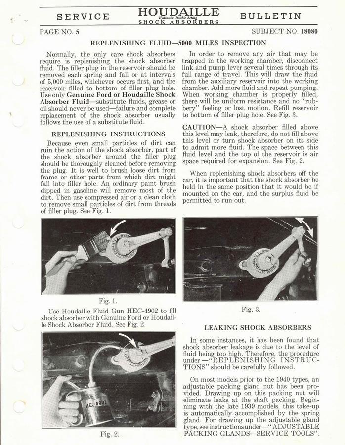

51woodie
01-03-2020 @ 1:19 PM
46 Here are some pages from the Houdaille manual that may be a help.

51 Woodie and MG
You guys are great. Thanks for the help. The service bulletin is exactly what I needed and the website looks like it has the oil and other items I might need in the future.
Thank you so much.

The original shock fluid is Ford part number M-4633-B The label on the can reads " Ford Shock Absorber Fluid M-4633-B has been especially compounded by the Ford Laboratories and is recommended for use in all types of Ford shock absorbers and in extremely hot or extremely cold temperatures"
In the years prior to the war there were three different fluids used in Ford shocks. The type of fluid in the shock was indicated by the shape of the head of the fill plug. After the war Ford was able to make one fluid to replace the three.
