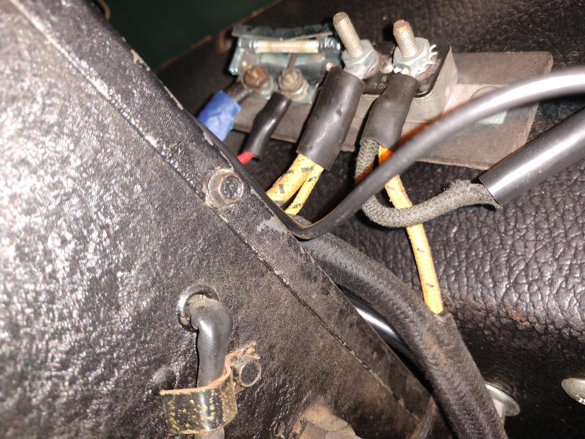

Tom,
I marked the wire with blue tape when I replaced the resistor...……..just haven't taken it off.
Great observation.

I would investigate what is going on under the masking tape on the wire going to the left terminal of the resister. It may be a problem waiting to bite you.

It hasn't cut off lately. I'll run it some this week and see if it happens again.

You're welcome. FYI, this type of circuit breaker is the type
that resets itself if the short is intermittent. So it's possible to
be going down the road with your lights flashing. I had this happen
once and it kept up til we found the short which was a bare wire
loose enough to short on the frame.
BTW, did you resolve the original problem of " ... from time to time it completely shuts off..."?

Thank you 39 Ken.

That is a circuit breaker to protect the headlight wiring in case of a short.

Quick question. On the same car this is a photo of the ignition resistor on the left. Can anyone tell me what the electrical component on the right is?
Sorry...…….I'm learning with this car.
