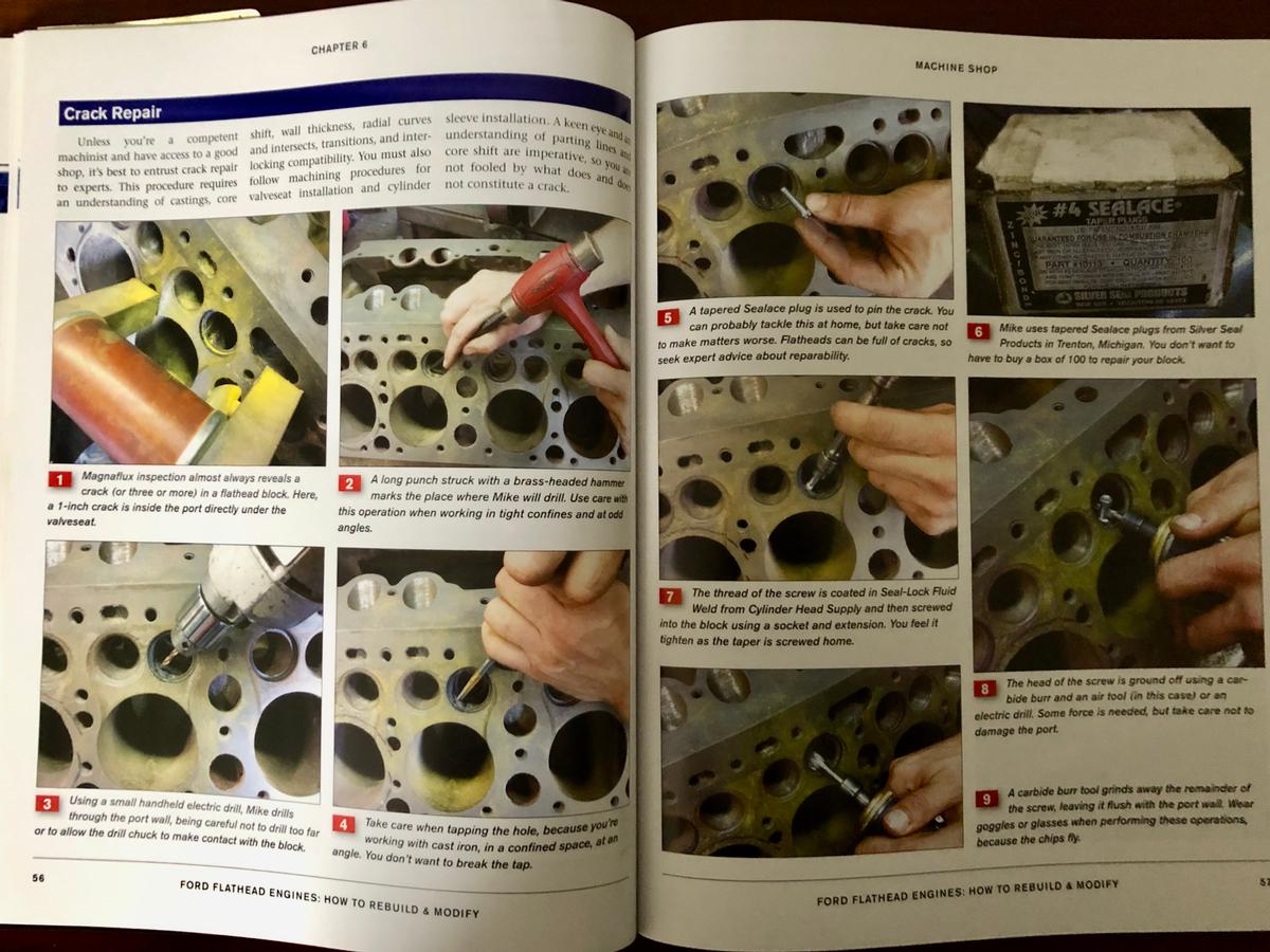

Just to confirm that a repair is possible and add to the information already provided, here is what H & H illustrated. Pages 56 and 57. A local machine shop here in CT does such a repair as well as others.

As mentioned, cracks that extend into the bore can be sleeved if in the right places. In the valve area, we install a threaded pin and resurface the block.. If the crack extends to the lower end of the bore, sleeving isn't recommended. If the crack is the result of freezing, it is likely there are hidden cracks, making the block junk.
