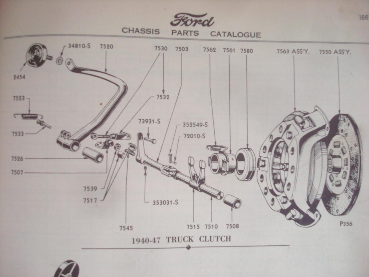

clutch/throwout
I looked this up in a FORD parts book and posted a photo
of the CLUTCH ASSEMBLY
see if this was what you installed,
you can see one good book solve problems
the problem might be the flywheel, if it was not machined correctly,
NAPA ? ?
Why not a FORD PARTS VENDOR ? there are many,
check out the V8 TIMES for ads !!!
I hope this helps
