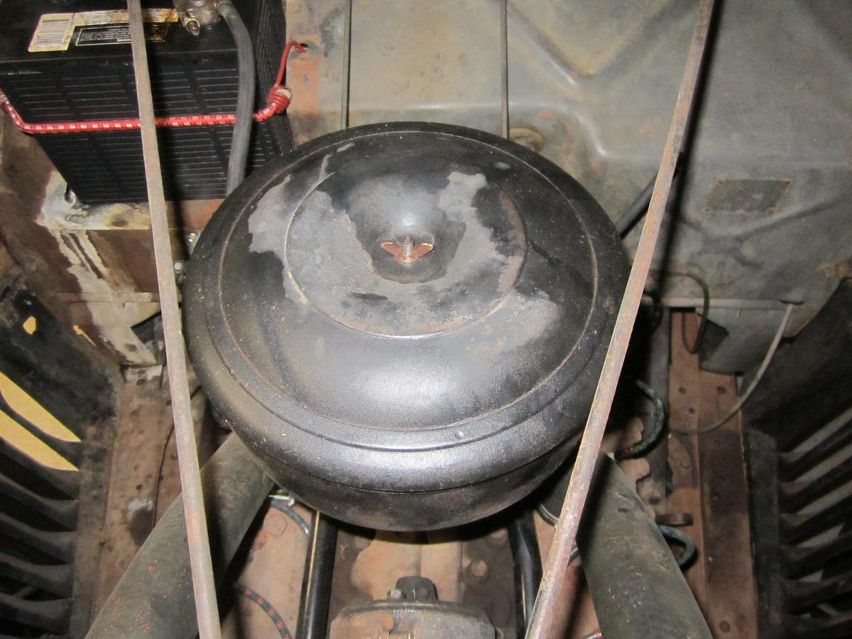

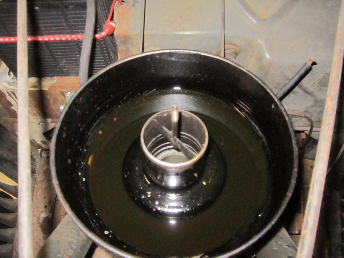

Hello, My 37 Fordor has a threaded rod built into the mouth of the carb. It is 1/4"-20 thread. A wing nut is used on top of the carb to hold the cleaner in place. See pics. Now comes the disclaimer... I am unsure if this is original 37 equipment. The car in general is bone stock, haven't run across anything that looks modified. Carbs are easy to change out so that could be my case, just don't know. Now I am curious just what is original for this screw. Need more input from others. Thanks, gregg

Yours is the optional oil bath air cleaner. I believe he is asking about the standard dry air cleaner.
