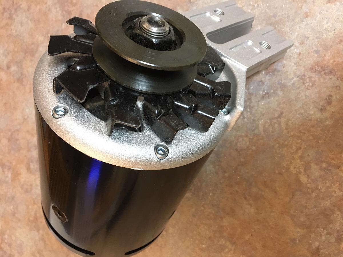

Hotrod. As Kubes said, these old engines start easily if all is in order. Good advice above on items to check/correct. My '46 Super Deluxe with 6V + ground, starts at a touch of the started button when warm, and turns over a few times when cold. I have a 6V lead acid battery from NAPA, but I have to admit that I did install a 6V + ground alternator by Powermaster, so charging is not an issue. It has always started in the three years that I have had the car.
