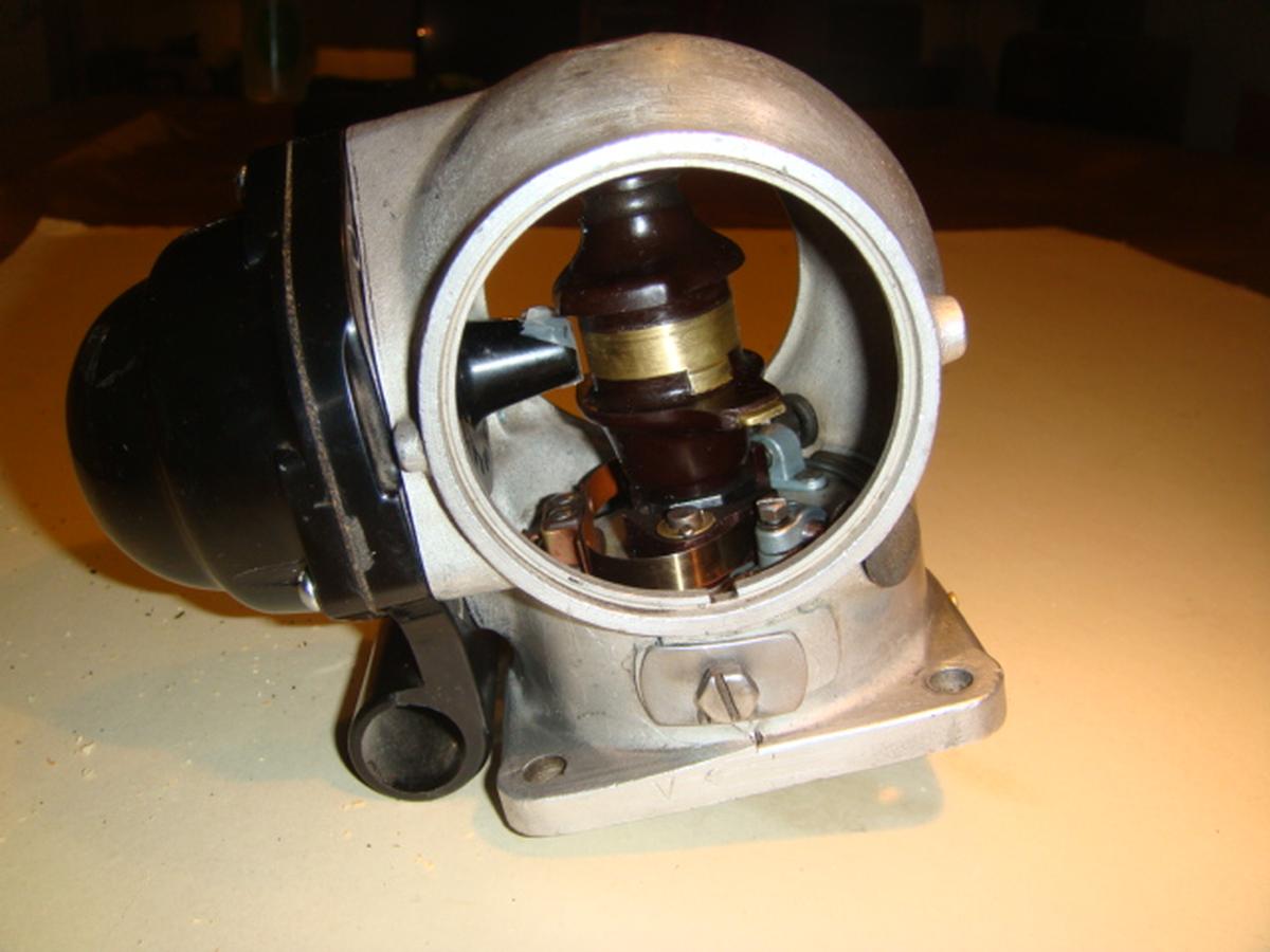

Help To ID This Distributor.
cokekid |
10-27-2019 @ 6:02 PM
Posts: 2
Joined: Oct 2019
I was wondering if someone can tell me what this distributor is from . Someone mentioned it was from a early Ford. Gerry
MG |
10-27-2019 @ 7:03 PM
Posts: 1247
Identical to the distributor in my '34 Ford. They were made to fit Fords 1932 - 1936....
ken ct. |
10-27-2019 @ 8:43 PM
Posts: 1513
Definatly 34-early 36 going by coik,rotor and rubber plugs on bottom. ken ct
cokekid |
10-31-2019 @ 11:54 AM
Posts: 2
Joined: Oct 2019
MG, ken ct. I had previously asked about this distributor but had not had the coil and was not sure what year it was. Appreciate both for answering my post. Gerry
3w2 |
10-31-2019 @ 5:30 PM
Posts: 812
The dome coil was adopted late in '32 production and used along with the 'tall' coil until the end of '32 model production. It was carried over as the only production coil until mid-'36 model year. The distributor housing is the '33-mid-'35 version and was not used in '32 model production. The '32 version is unique to that model year.
