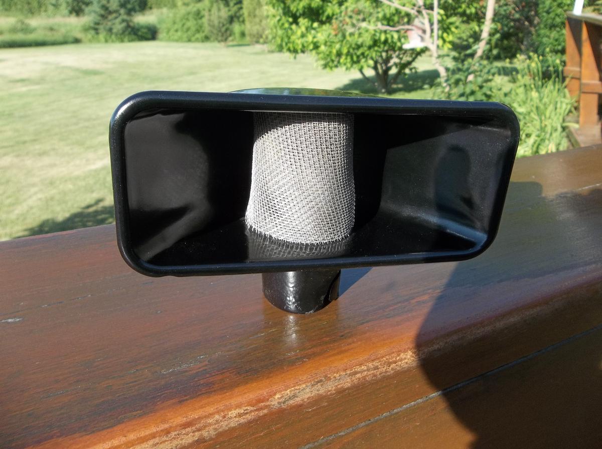

Thanks Grant. Fantastic information. And your screen looks incredibly clean, exactly the opposite of mine, but definitely the look I'm wanting to achieve also. Because you had to make your own I assume you were unable to find a source to purchase filters as well. Interesting why this part is so hard to find. Thanks a million for the idea. I can't wait to get started on mine.

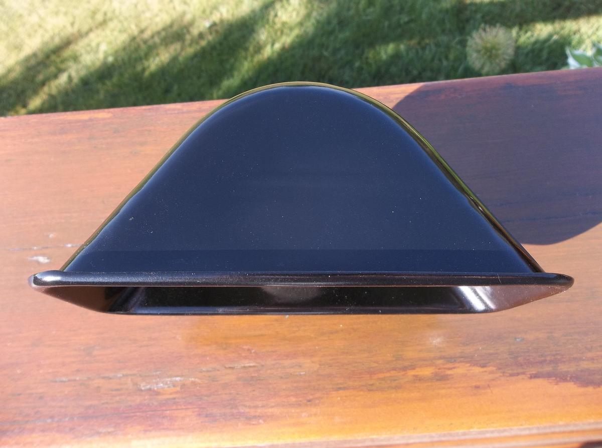

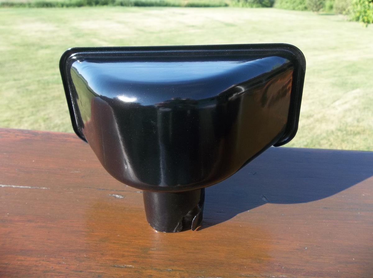

Hello Paul. Several years ago we restored an oil breather scoop for our '36.
It's the Ford of Canada version, off a '34 engine, but I suspect that yours is a similar design.
Attached are photos.
A long strip of stainless steel screening was cut to the correct height, and then wrapped around a shovel handle to make a hollow cylinder. After clamping the screen tightly in place, the end of the screen was glued with a generous coating of J B Weld.
Following several days of curing the stainless filter element was slid off the end of the shovel handle and press-fit into the scoop.
Hope this helps. All the best with your project.
