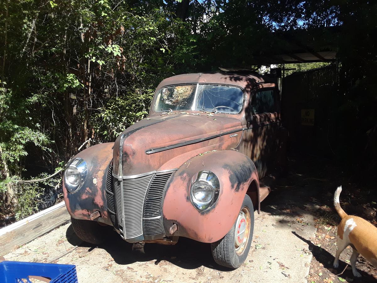

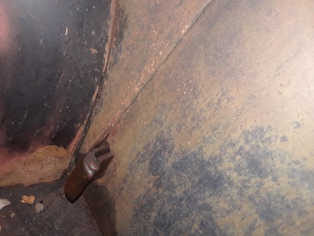

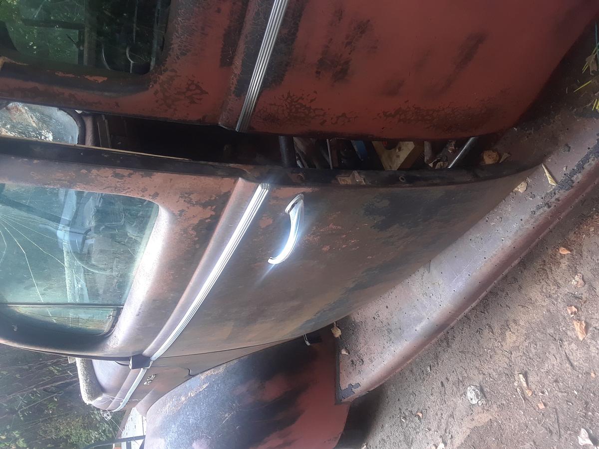

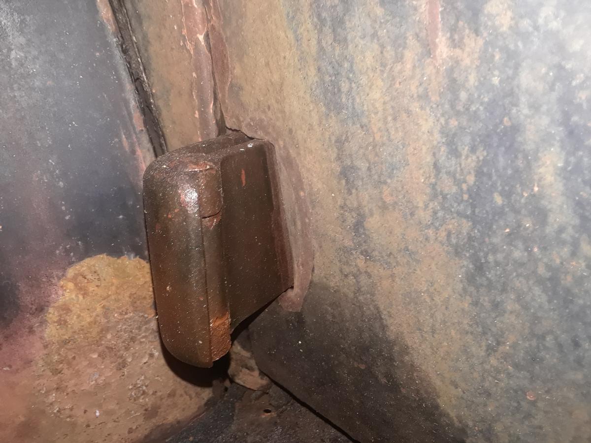

Tried a search - new member here with 1939 coupe and sedan - also 1940 sedan which I wanting to replace the drivers side door hinge. Looking at buying a set from MAC's and looking at the door side I will need to drill it our ? Any guide would be appreciated. Thanks.
10-15-2019 @ 10:26 PM
Posts: 2883
Hi Lawrence, Welcome to the V8 Forum. Not positive from your pictures, but it appears to me that your problem is not the hinge, but rather, the frame of the door itself. Remove the inside door upholstery panel to reveal the issue. I think you'll find that the frame has buckled, and will need to be rebuilt. You'll probably have to cut (and bend back) the inner panel for access, then reweld that panel after the frame repair. The tough part here is proper alignment, which should be confirmed with the door closed, a temporary brace installed, to facilitate a proper repair while the door is open for access. Please let us know if this is indeed the problem, and if my suggested repair works for you.
