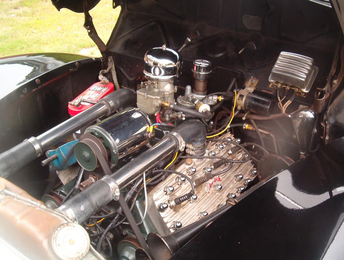

im running a Stromberg 48 on 59ab engine in a 40 coupe runs good, the needle and seat was replaced with a grose valve , had too many problems with holleys,power valves ect ect

whizzerbug, You are driving around with a fire hazard. It would be a shame to see such a pretty engine compartment ruined by a fire. I am sure that the rest of the car looks as good as the engine compartment. Using a plastic filter and a rubber hose on the output of the fuel pump could cause a serious fire if either of them leaked. Rubber hose should never be used on the output of the fuel pump. It could leak and you will have a steady stream of fuel to feed any fire that develops. A leaky rubber hose on the input to the fuel pump, will cause a lack of vacuum on the input side and the pump will not be able to suck fuel from the tank. I would use a filter that fits inside the sediment bowl of the fuel pump, if you feel that you need extra filtration. Replace the rubber hose with a steel line. I would also move the coil closer to the distributor to shorten the high tension lead. It would improve the performance of the ignition system.
