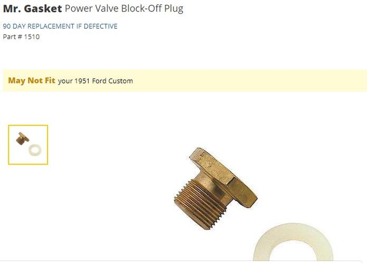

i would like to install a ( power valve block off plug ) in my Holly 94 carburetor to determine if this is the source of my leak down problem.
What can I expect as far as performance with no power valve.
I will attempt to upload the picture of the plug from Advanced Auto

Your leak-down problem is most likely the power valve gasket, not the power valve itself. Without the power valve your performance would suffer significantly. You can do a quick check on the valve by sucking on the end that does not go into the carb. If the valve moves it probably is not leaking.
The power valve is closed under high vacuum conditions and opens under low vacuum (wide open throttle) conditions to enrich the mixture when the engine is under load.
I use the gasket with the triangular cutout. I hand tighten it and thenturn it an additional 1/6th turn. Then I fill the bowl with just enough fuel to cover the top of the power valve and let it sit for 12 hours or more. The fuel should not be below the top of the power valve, if it is I tighten the power valve another 1/6th of a turn and repeat the test.
If the gasket is leaking, it will be wet.
