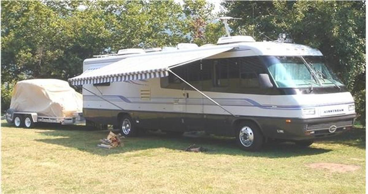

I prefer an open aluminum car trailer. Less weight an wind drag. I use a 7816 Aluma to haul my 1934 Fords, weight 1100 lb. and has two 3500 lb Torque flex axles with 4 wheel brakes. Open trailers are easier to load and tow, but don't offer use as a storage garage. I also had a 20 Ft. Horton Hauler enclosed trailer with ramp door and inside beaver tail floor in the back. It had two 5500 lb Torque Flex axles (No springs) Any car hauler should have the Dexter Torque Flex axles. The enclosed trailer carried more weight and the cars were inside, so we used it for a move from FL to NC as a moving van. 10 trips and no problems. SOLD it an use the open trailer for going to tours, just completed out 11th Glidden Tour. Only drawback t open is somethings you'll need to wash your car after trailering. Must haves: Light Weight, Torque Flex axles, 4 wheel brakes, D-Rings to secure the car to the trailer and a triangular tongue box for tools, a jack and a wash bucket & supplies, 4 10,000 lb straps, two spare tires, good lights and aluminum ramps. 10-15% tongue weight when towing. I cover the cars when parked (After being awakened by people taking flash pictures of them at night) AACA has a good towing Forum with lots of info. https://forums.aaca.org/forum/92-garage-trailer-towing/ 1934 Ford's since 1972
