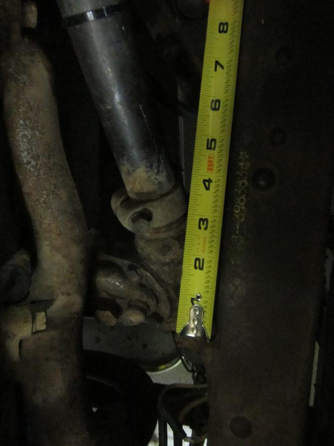

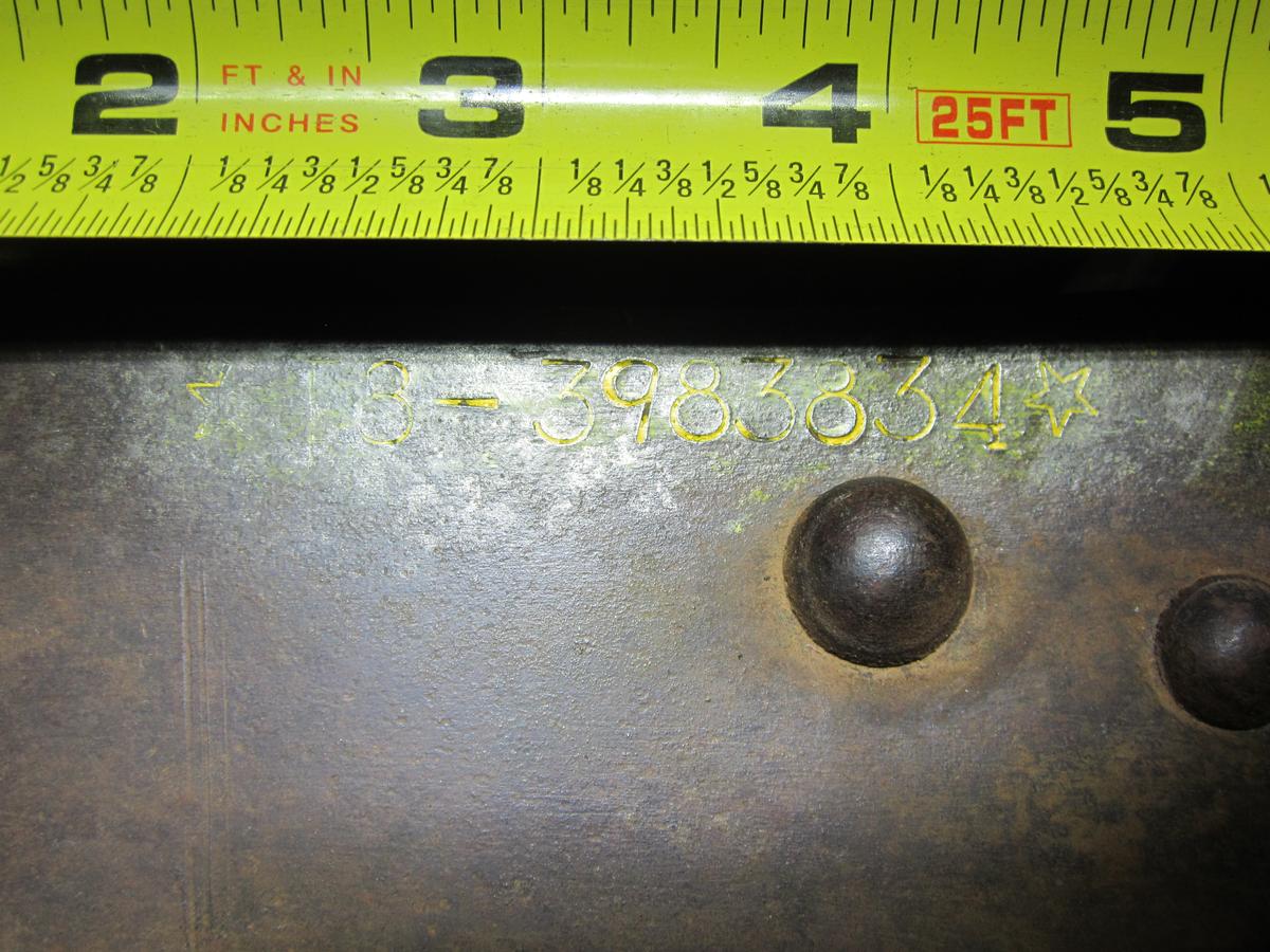

1937sedandelivery
09-29-2019 @ 2:51 PM
Posts: 501
Joined: Jul 2014
Here is an example of the VIN on the frame in front of the cowl, driver's side. This is from my 37 Fordor.
