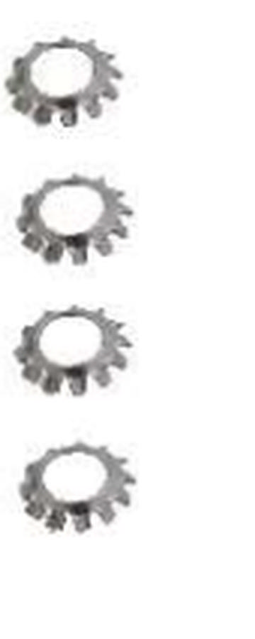

I am looking for anyone who has the original hood bolts and star like washer still on their 1937 Ford.
The bolts have a hole in the head and I believe are wired to the other bolt to hold the hood on. All the pictures I find on the web no one wires these and the modern washer is different with not explanation where it goes.
Does the washer go after the bolt head or in between the bracket and the hood? Which way does the teeth on the washer go for it is like a cup?
Below is the washers picture I am unsure where they go or which way.

I honestly don't think those star washers go with those bolts. The star washers shown appear to be a "cup" style washer and the bottom of the bolt head is flat. The bolts for the hood are shoulder bolts and are safety wired together so they cannot work loose.

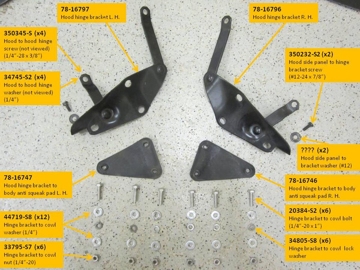

I agree. The Green Bible and Chassis Parts List book indicate the washer is a standard 1/4" flat washer.

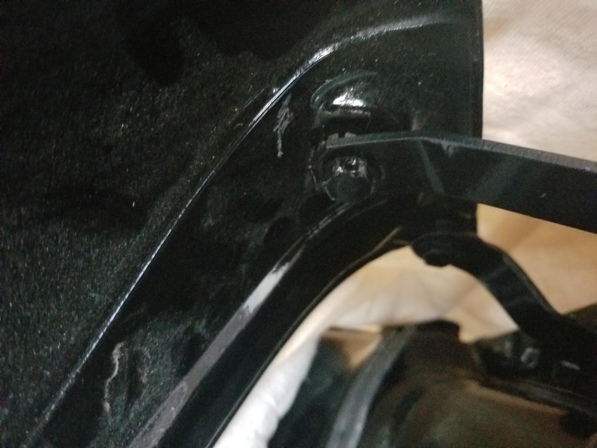

It is possible but picture above does not show the bolts or the washers. All the catalogs I have looked at show a wavy washer I assume goes right under flat bolt but I have seen some bolts with a shoulder which my bots which are original don't have.
The washer I suppose are subject to debate for I simply don't know over time what has occurred. I can take more pictures showing the holes in the hood in which the "cup" like washer appear to grip into. Why I have no idea, it could be to prevent spinning and ware is on washer.
