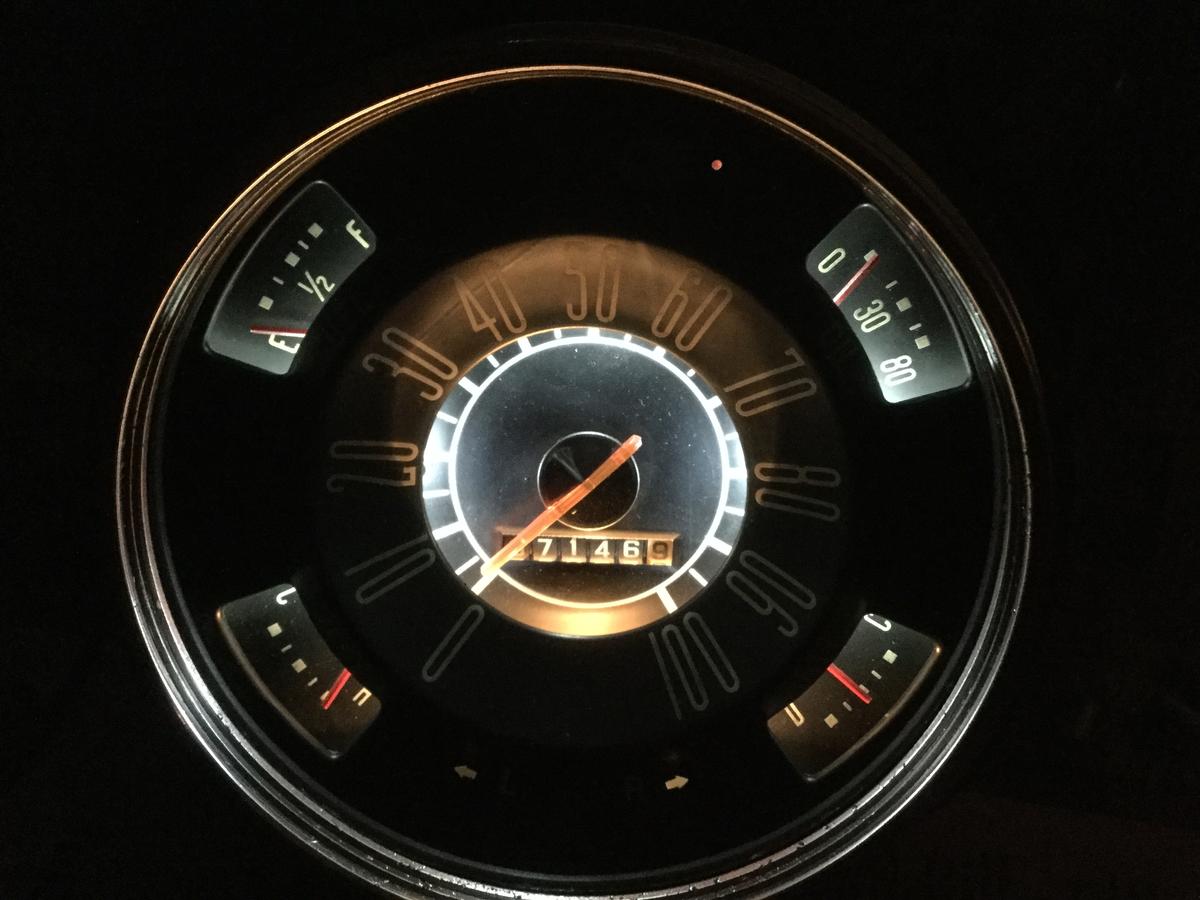

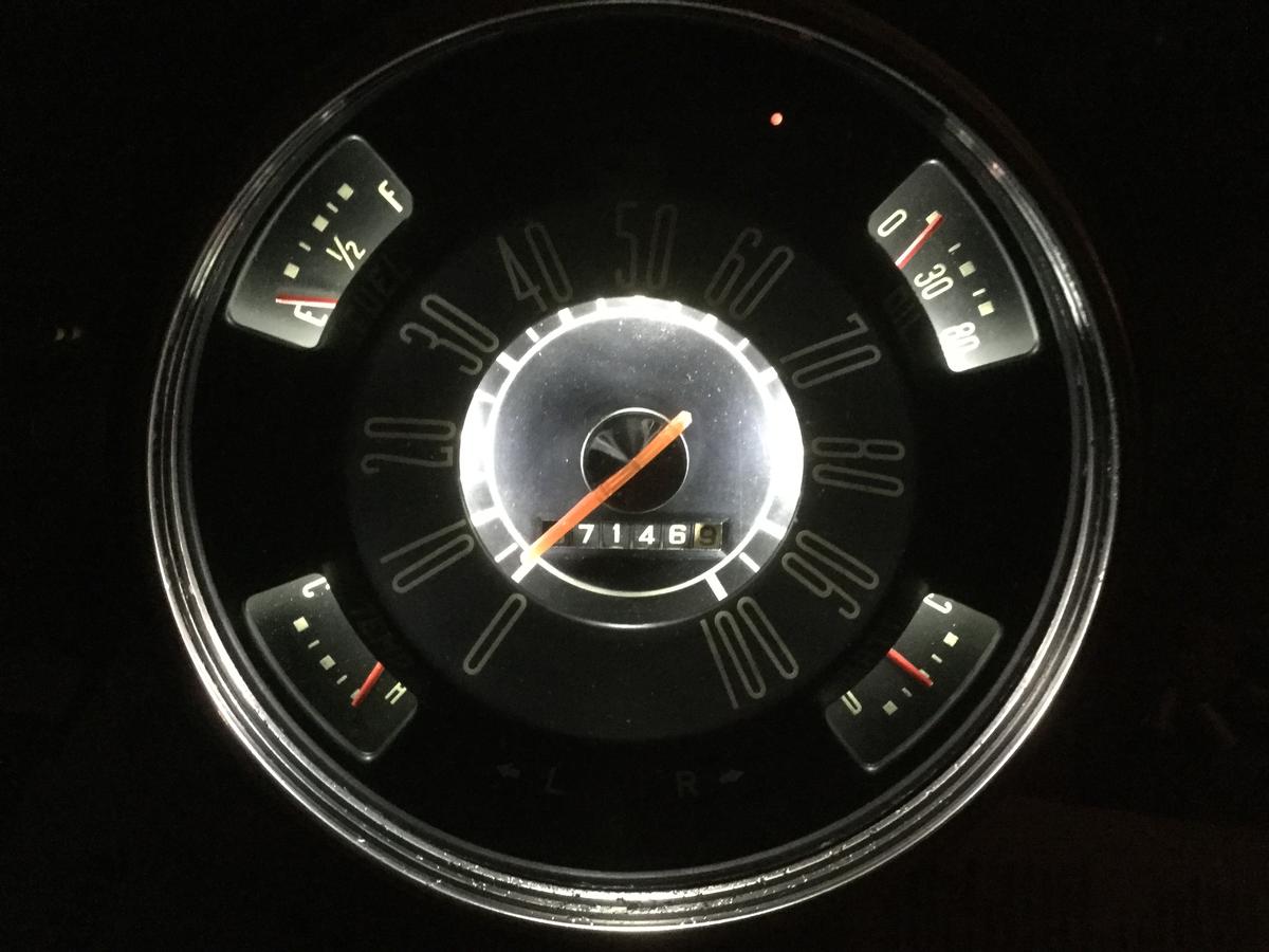

Model B
09-17-2019 @ 5:40 PM
Posts: 95
The black light filters on my '50 will not allow any light through. I have tried LEDs in place of the original bulbs and the
light still did not penetrate the filter. I have a nice extra cluster that I have removed the filters from and installed LED bulbs. I will post a couple of pictures with the LED bulbs installed...one picture has clear LED bulbs (white) and the other has Green LEDs installed. My plans are to install/replace the cluster in my car...when I feel ambitious!
Compare the first picture with the second picture. I somehow inserted an extra copy of the second picture!
