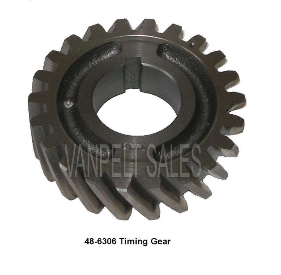

engine seems to be running out of time Distributor set ok. pulled timing cover did not see any damage however only the cam gear was marked and crank gear was not. How do I know if the crank and cam gears are aligned correctly? I thought it might have jumped gear but there's no way to tell because there's no marking on the crank gear.

Is this a fresh rebuild and both timing gears replaced, if so do you have the
old gears to match up. No surprise that replacement gears not marked or
marked wrong....We did one last month and the cam gear has 3 dots? Guessing game 'pick a dot' hope for the best nope return it for another.
Having a shop manual is a must, cause you just can't keep all this stuff in
your head. Engines vary thats why we have books and lots of them. Some
engines use the keyway for the stamped dot on the crank. In this case I
would get No. 1 piston up top dead ready to fire now look and see the cam
gear dot should or will be at 6 0'clock whats the crank gear look like? where
abouts is the keyway if what I'm thinking the key should be 12 0'clock to
mesh with the cam dot. From the looks of this you may be off only a tooth.
And then a lot of gears are laser or acid etched hard to see this little dot.
But my mind still says it should have a stamped dot. All I can think of for
now you can see the dot is 6 teeth from the key way sam

Thanks very much for responding. For the last few years I've enjoyed bringing back to life a '39 standard that had been in a garage for the last 40 years. After a tune-up and unsticking a valve or 2 it''s worked fine until now. It started making a popping sound in the exhaust so I did a compression check. All the cylinders read over 100lb. except for one, which read about 60 or 65 lb. I pulled the heads off, and took care of that problem. After I reassembled everything, the problem persisted. I advanced the distributor timing and the popping went away, however it's not the correct setting. On higher acceleration it just flattens out. The vacuum advance is working fine and everything appears legit. Thinking it might be the distributor, I considered buying an upgraded one. I spoke to someone at Bob Drake who advised me to check the timing gears, so I exposed the gears and there's no damage to the cam gear. The crank gear has a couple of chips on the outer edge, otherwise it's ok. The cam gear is the press on fiber kind, which has a marking line, but the crank gear has no marks at all. When the cam gear is at 6 o'clock, the keyway on the crank gear is at around 10 o'clock, which makes me doubt that would be the timing mark. Thanks again. I really appreciate you taking the time to help me out.

The crank gear timing mark is on the face of the third tooth to the right of the keyway. The gear could have been installed backward which would put the mark on the engine block side. The marks are not always very clear and do vary in appearance, but now you know where to look. Remember the crank rotates twice for every single rotation of the cam.
