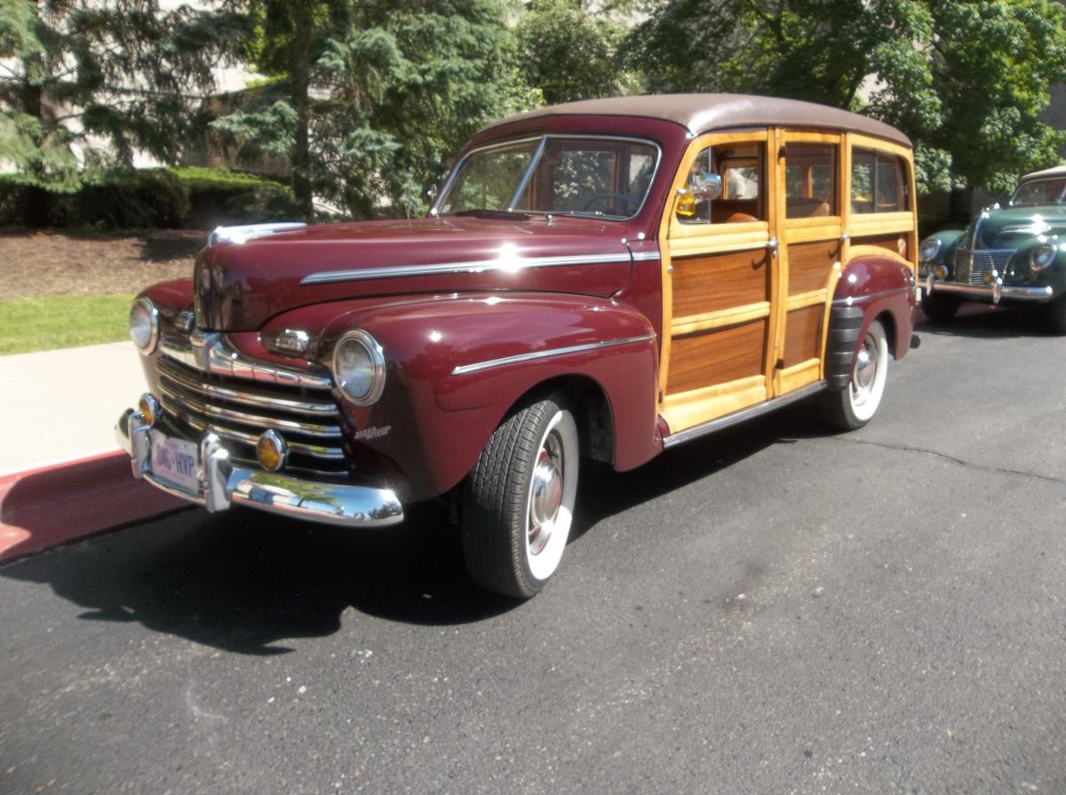

You could try contacting John Hogg. He restored a '46 wagon 3 or 4 years ago, and may know of a roof material supplier.
Attached is a photo of his car at the 2018 Grand National in Dearborn.
John is in the club Roster under Ontario Canada.
