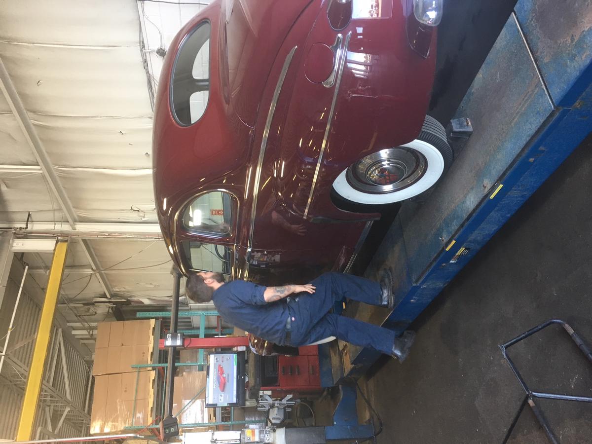

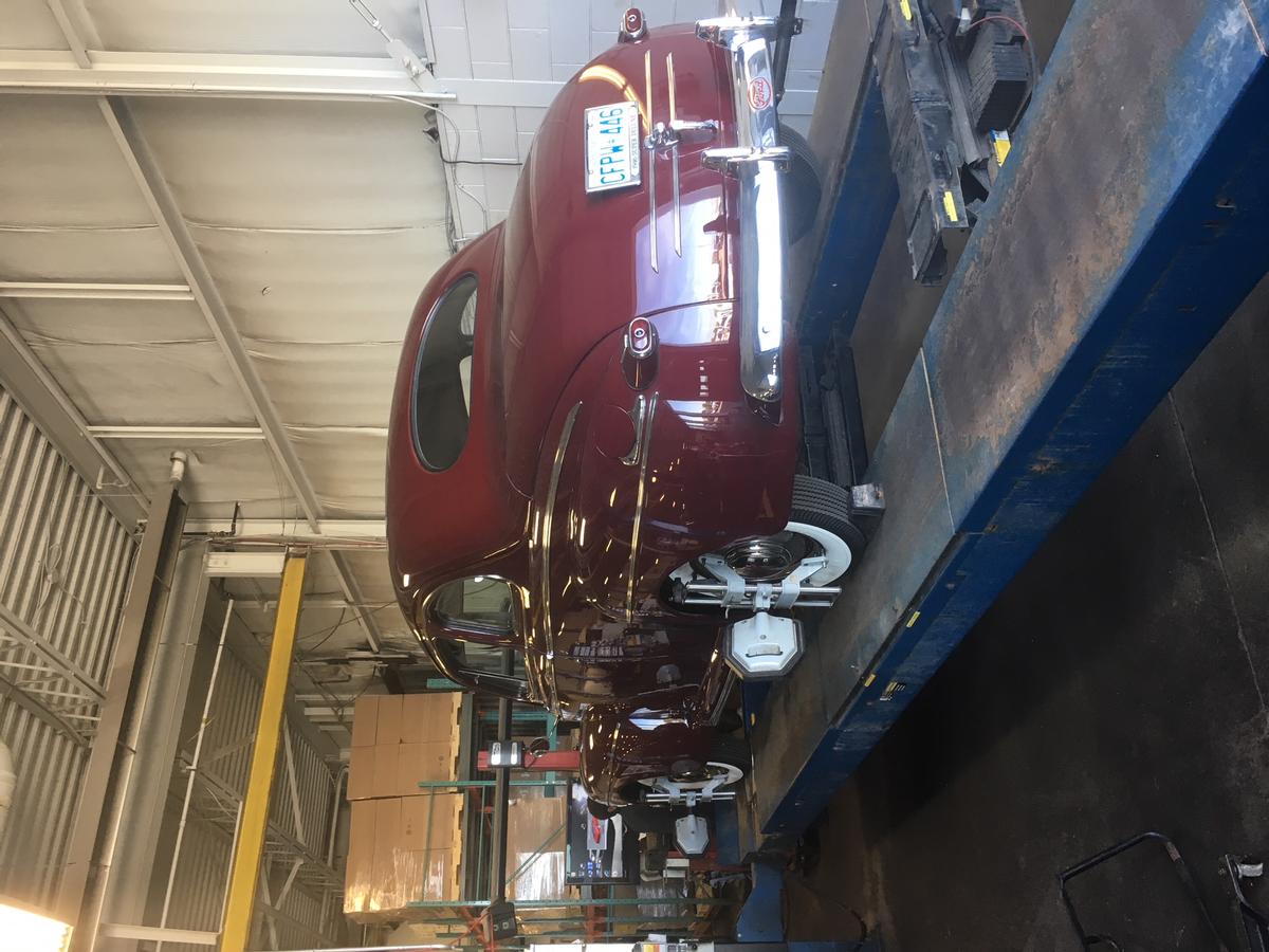

I took my '46 to the local Ford dealer to have the toe in checked. As 37ragtop said, that is about the only adjustment that can reasonably be made. Assuming all the other steering parts are I good shape, toe in is all you need to adjust. I took the specs with me, but the Tech had to convert inches to degrees, as the new laser units work in degrees. The job cost me $90.00. Check out your local Ford dealer, as they may be able to do the job.
