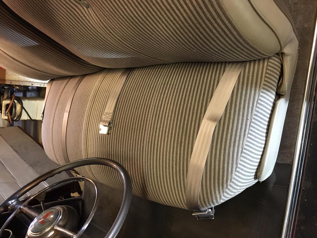

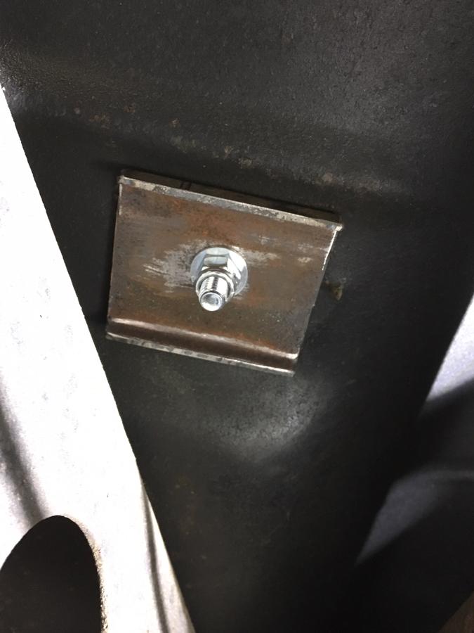

Mark I installed lap belts in my '46 and thought about shoulder belts at the time. Someone on the Forum may have an idea of how to do that, but I didn't want to remove interior pieces to figure out if it is feasible without welding etc.. I bought my seatbelts and mounting hardware angles from Seat Belts Plus. I made 1/8 x 4 x 4 reinforcing plates for under the floor pan, with GR5 bolts and nylon lock nuts. I found the 60" belts that I bought are a bit short for larger people, and should have ordered 70" belts.
PS I don't know why the pictures always turn 90 deg.

Thanks to all who replied. The 4 x 4 reinforcing plates are exactly what I had planned. I'm no beanpole so I'll measure to see how long the belts need to be. I think I’ll stick with lap belts for now (no headrests or airbags) and keep the info on shoulder belts in mind for the future. BTW, the comment about people slamming doors brought back a memory from my childhood. My dad had a “48 sedan and when people slammed the door he’d go “It’s a Foooord!”
