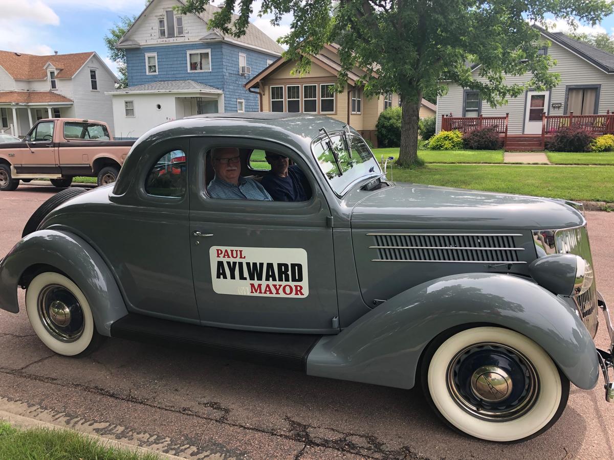

Smooth as Silk
No boil over or hot running
1934 Ford
