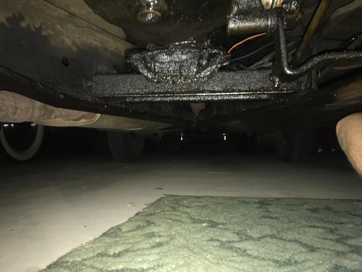

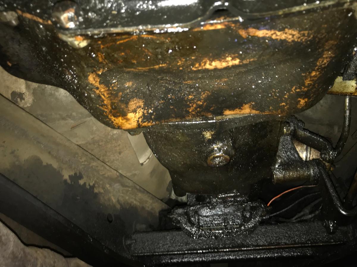

Hi everybody. I just signed up and am quite inexperienced with forums, so apologies for mistakes/breaches of protocol, etc. that I'll probably make. (Let me know what I'm doing wrong and I'll try to learn quickly!) I'm in the process of finishing the restoration of the '51 convertible that my father began shortly before his death. I hit a pretty big roadblock when I went to install the donor 8BA and transmission. These came out of a four door '51 so I wasn't expecting for there to be any issues with fit. However, as you can see from the pictures, the mounting points for the tranny are directly over the frame element that supports the transmission. Equally as baffling is that the mounting plate that bolts to the transmission is wider than the mounting points on the transmission. (I got the mounting plate from Shoebox Central, so I'm assuming it's the right part.) I took the engine and transmission out of the donor '51 myself. Anybody have some insight?

Ford made a change in '51, moving the rear motor mount forward 6" and making it larger. The change was made to accommodate the automatic transmission. I think your donor car might have had a 49/50 transmission installed. Are you positive your donor car is in fact a '51? Welcome to the forum.

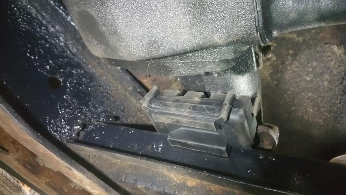

Something that bothers me about your picture is that the cross member supporting the motor mount looks like a piece of angle iron that has been welded in place. My '51 convertible has a channel (open side of the "U" pointing down) a couple of inches wide that is bolted in place. I just tried to take pictures but the barn is dark and the jack wasn't handy, so here is what I got:

Posts: 413

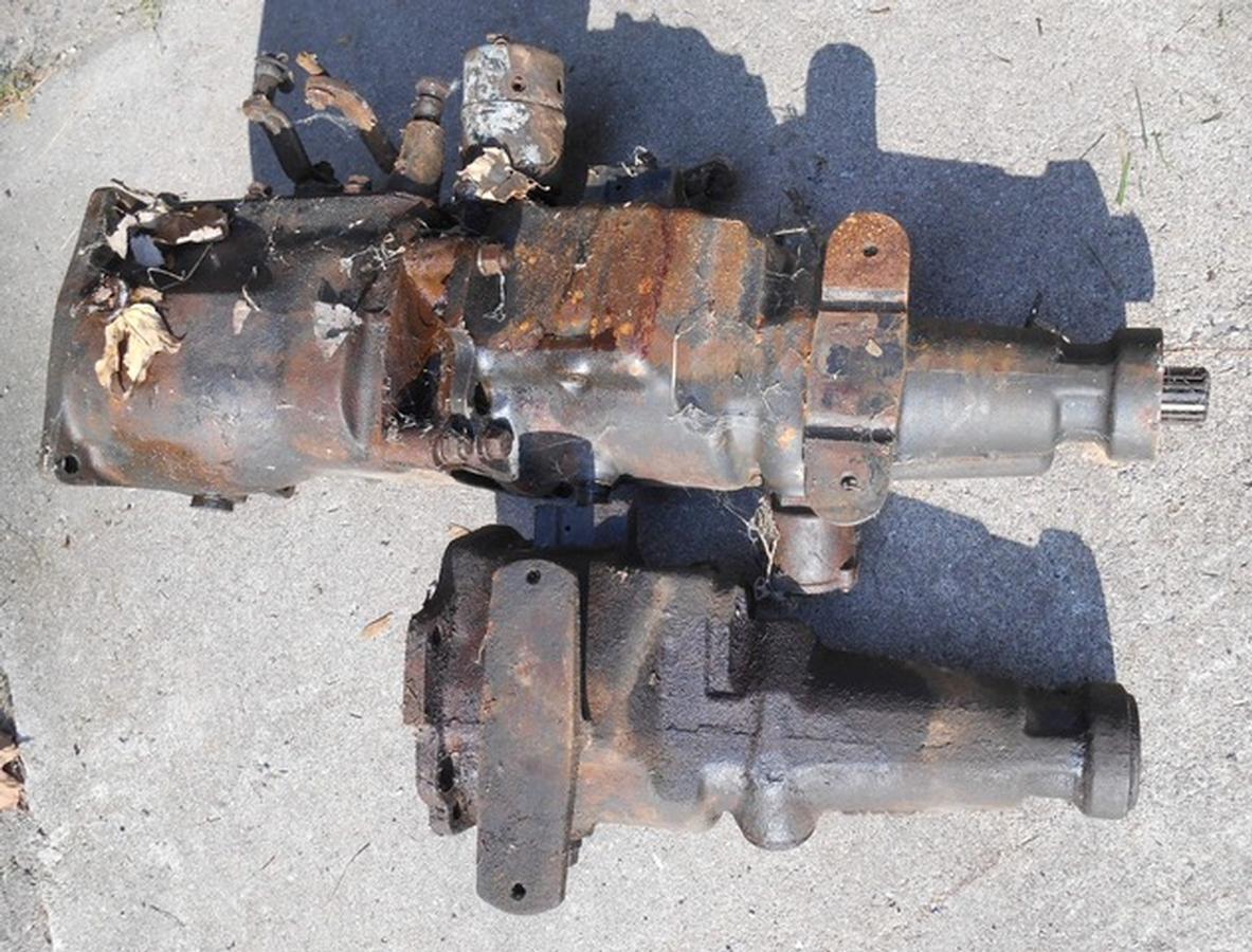

On third look, your crossmember might be correct but the bolts are covered with undercoat and I didn't look at it long enough. I found a picture of a 49/50 transmission (top) and a '51 tailshaft (bottom) that should help. These are overdrive transmissions, but that doesn't matter.

The 49-50 engine support hole spacing is 5" and the 51 spacing is 6 9/32". It looks like the transmission has the 1949-1950 spacing.
