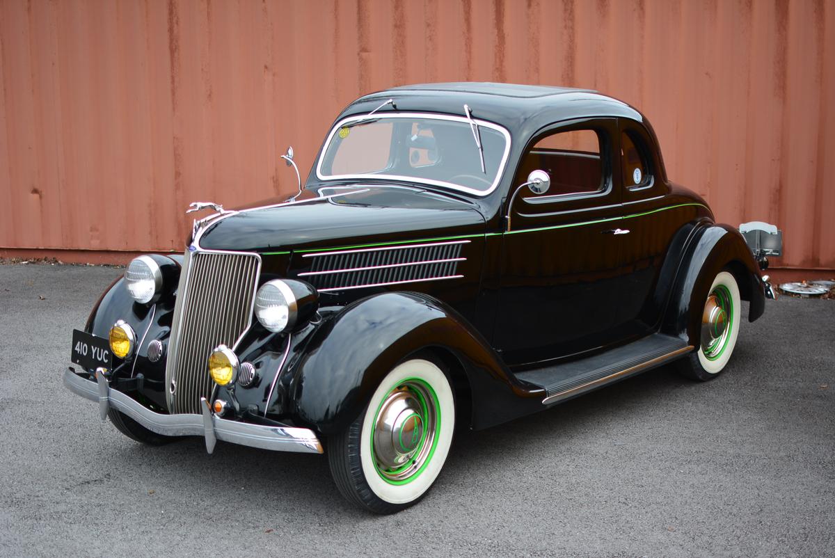

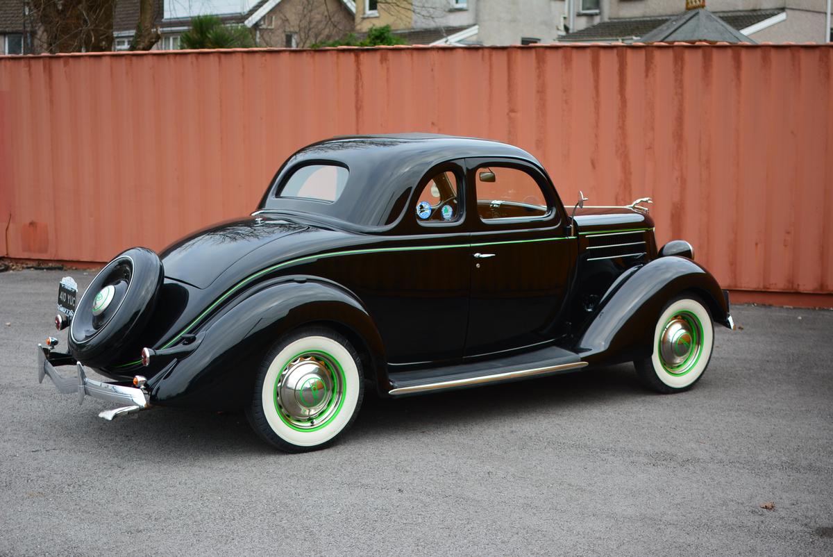

I have attached a few pix of my car for your info. You will have to overlook the chrome dash in the car, that is from my street rodding teen days.. Can't bring myself to bring the car back to total stock.
