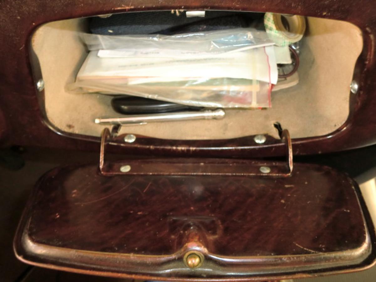

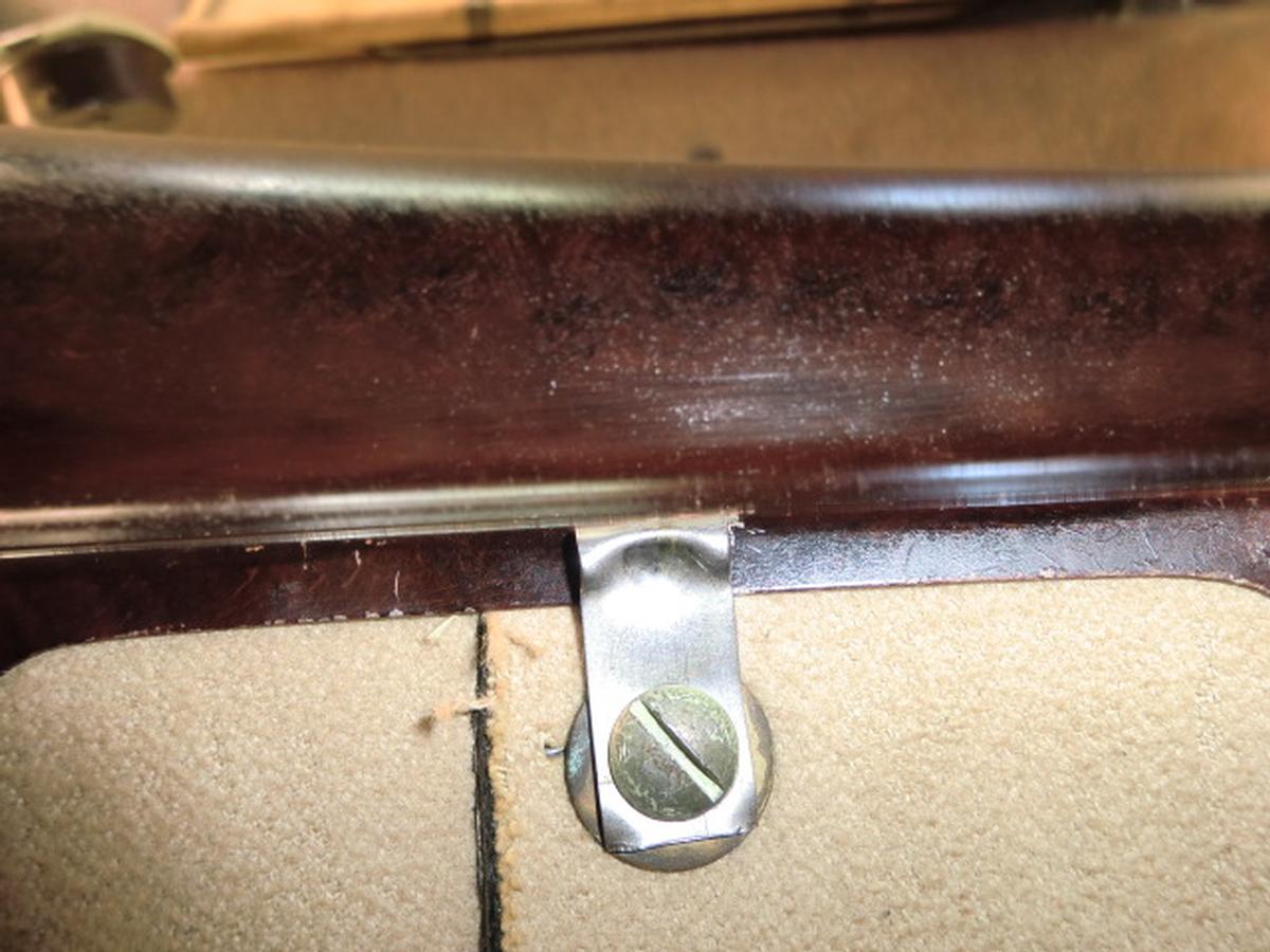

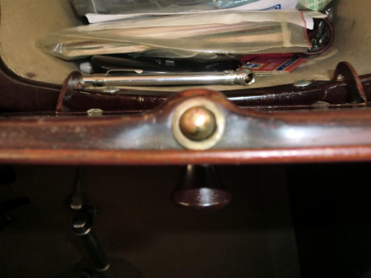

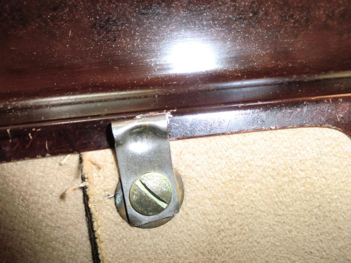

Pictures of the glove box in my '34 attached.... I am not experiencing the problem you describe. My door when closed stays closed even when I go over bumps. The door opens and closes crisply. I'm thinking that you might have to bend your detent a little bit or put a washer under it in order to lower it and therefore increase the tension between it and the ball.... Go to this site for the parts you may need > https://www.ecklers.com/ford/glove-box-door-latch-repair-kit-ford-32-14824-1.html or, this site > https://www.bobdrake.com/FordItem.aspx?Item=40-43000-RK I see in these kits there is a black rubber piece which I do not have. I'd like to see a picture of its location when installed. It probably goes between the detent and the the dash opening for the glove box door. Yeah, that's where it goes. I might have to make one of these....

thanks Dave and MG Yes, the wire "spring" is installed... The car was completely apart when purchased and I'm now done with the woodgraining, so so I was pretty surprised to find a less than smoothly operating glove box door. I'm used to 39 glove box doors which work like a charm...God Bless 'em! I'll post a photo of my installed 34 door today, but it looks identical to the MG install (and thanks for the photos, I'll fabricate the small clip and some kind of rubber bumper)

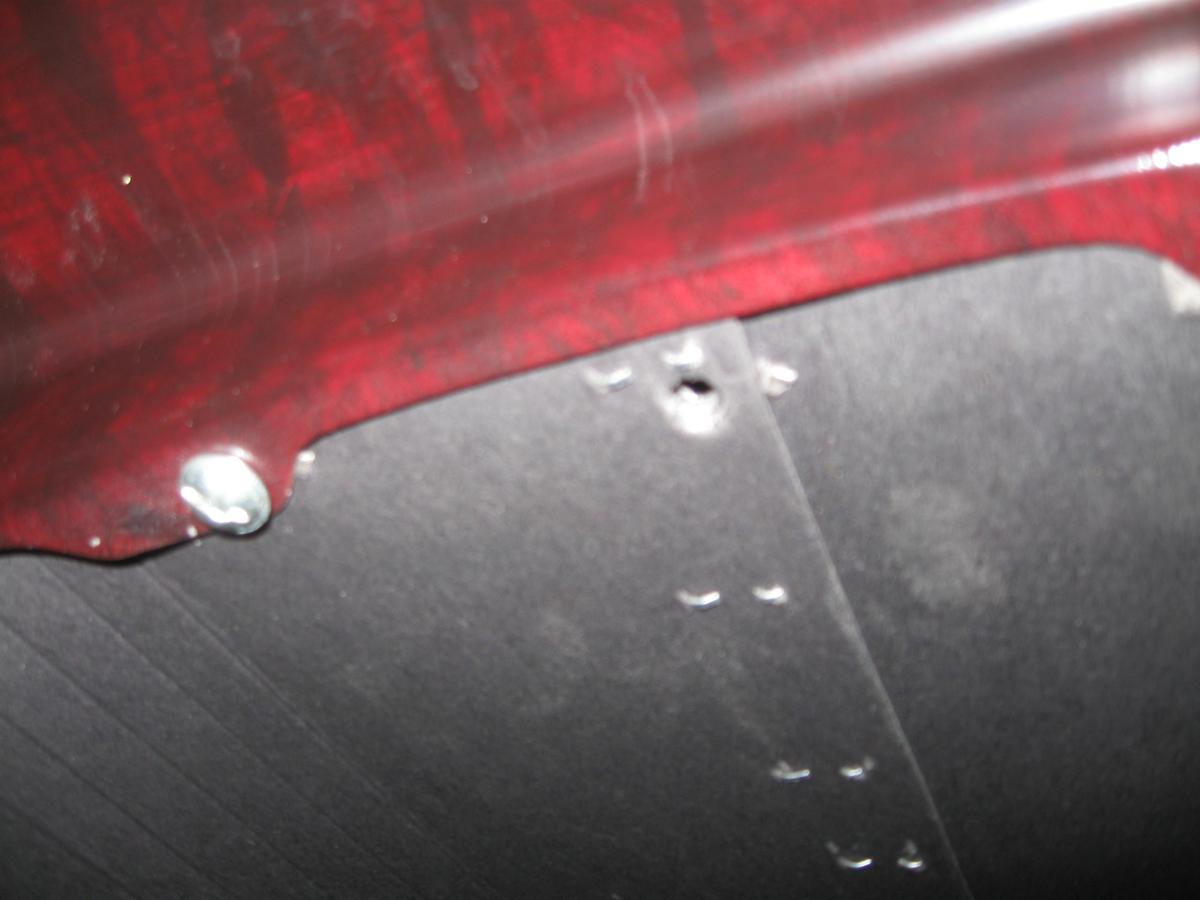

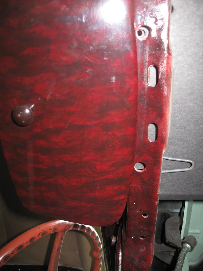

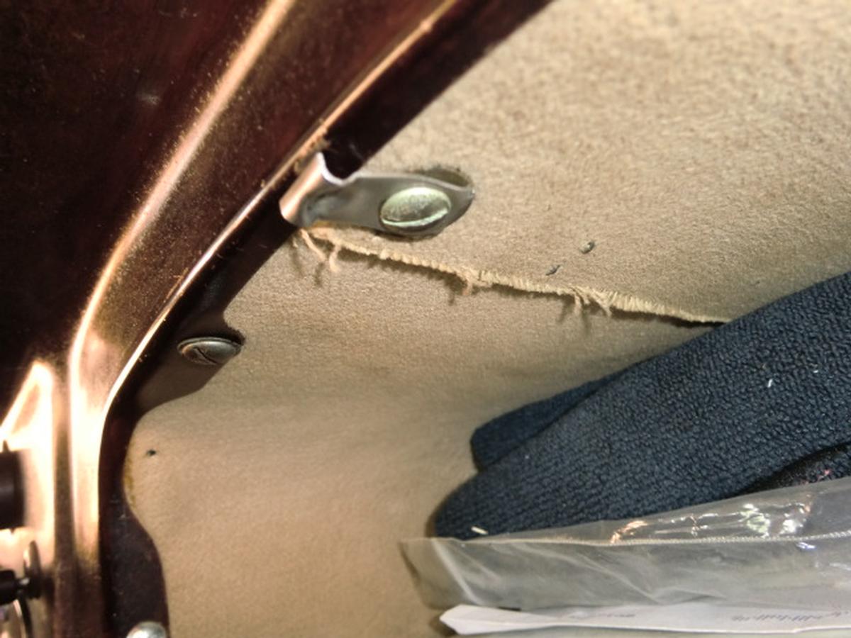

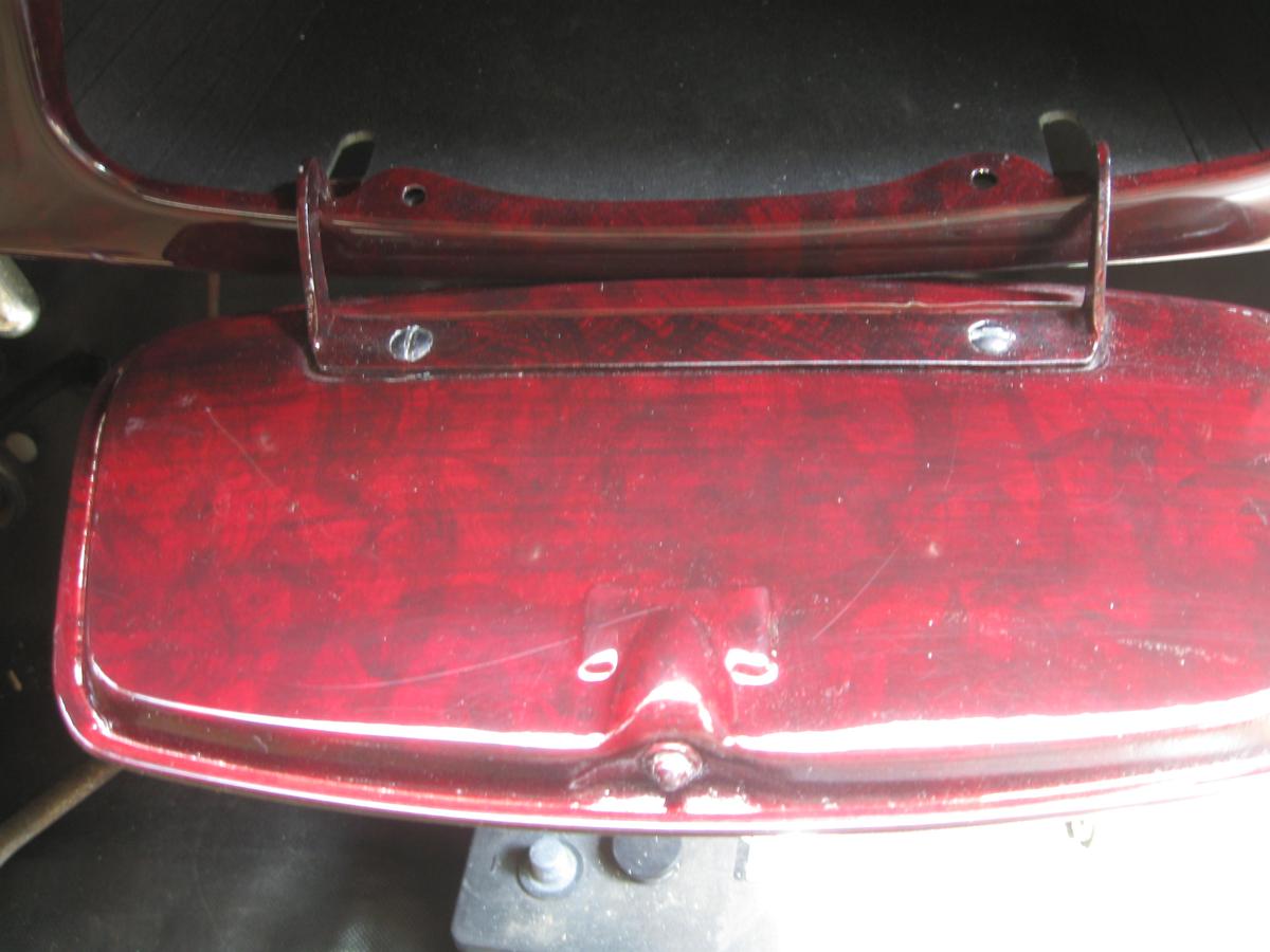

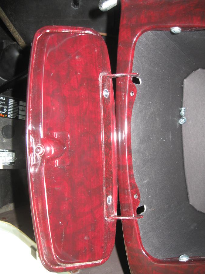

Here are some photos of my installed door. (I just finished wet sanding so there is some residue) Can the wire hook on a different way? 1 and 4 are looking up from the floorboard. (the site software rotated 3 and 4 which is irritating). It seems the curved ears of the bracket are supposed to rotate the door up and down, but mine kinda grabs a little and isn't a smooth operation

Judging from your photos, it appears as though the arms on your hinge do not line up well with the slots in the glove box, especially the upper one in your third photo. In that photo it also appears that the upper hinge arm is bent out of shape whereas it should be straight and exactly 90 degrees from the base of the hinge where it is attached to the door. You could always enlarge the slots in the cardboard of the reproduction box if the hinge arms are in fact straight and at the correct angle.

Thanks Dave I'll take the hinge off and straighten out the arms...so should the hinge arms fit through the cardboard box slots as well?
3w2 |
06-30-2019 @ 5:21 PM
Posts: 821
The design intent was that the hinge arms should clear the sides and back of the slots without touching.
