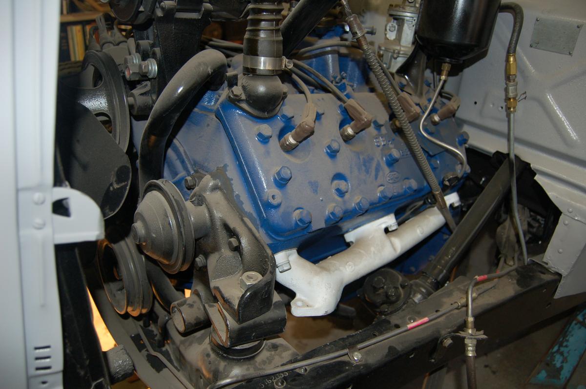

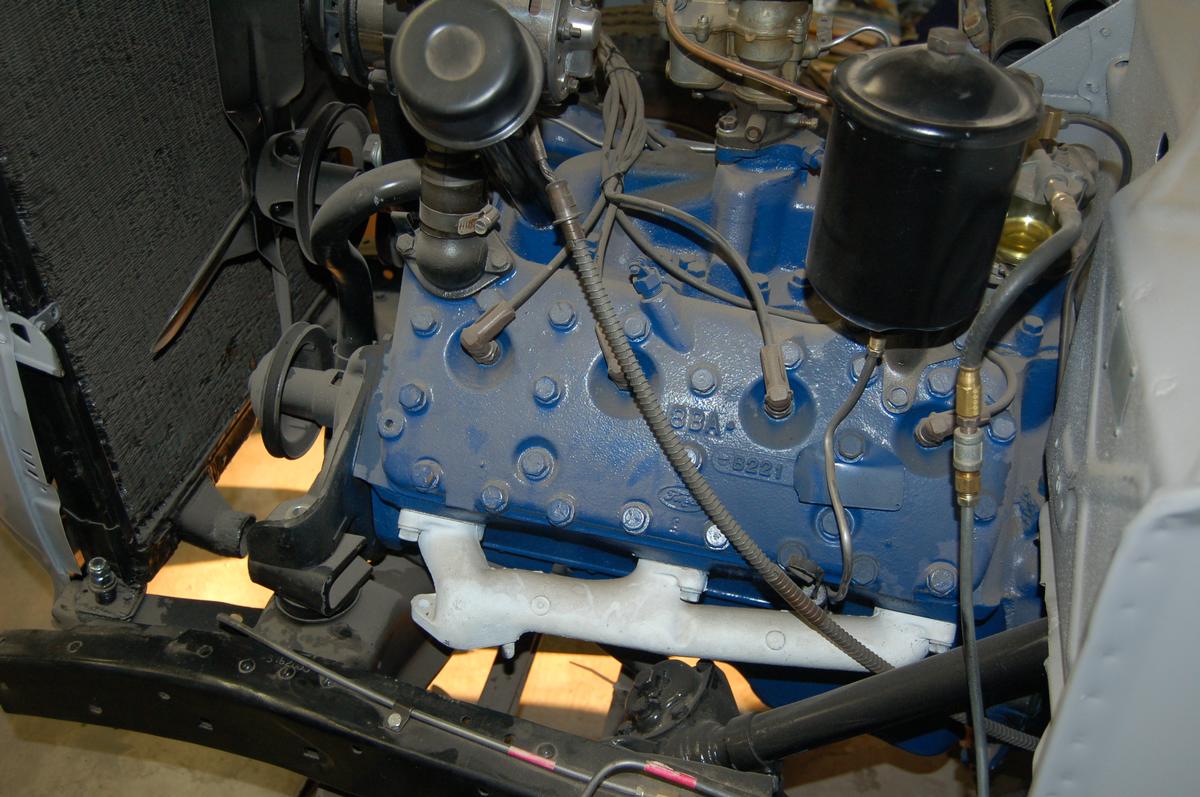

I have attached a couple of pix of an 8BA engine in my friends '37 Ford 1/2 ton.
