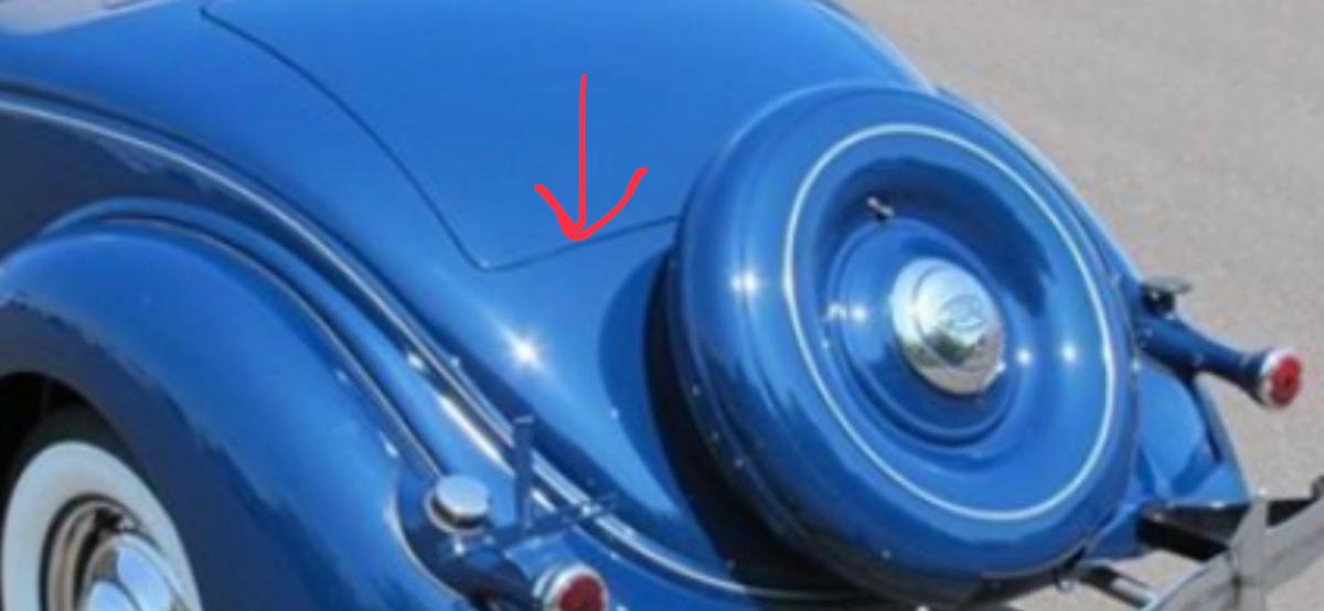

1) Rumble Seat Weatherstripping: I have a weatherstripping kit from Bob Drake that provides a two part seal for the lid on the left, right and upper portion. One rubber extrusion mounts to the body and another mounts to the lid. They meet to form a seal when the lid is closed. My issue is, the bottom gap between the lid and the tail pan remains open so water can flow directly into the trunk area of the car (see arrow on photo attached). How do I seal or manage the water to keep it from collecting on the floor of my vehicle?

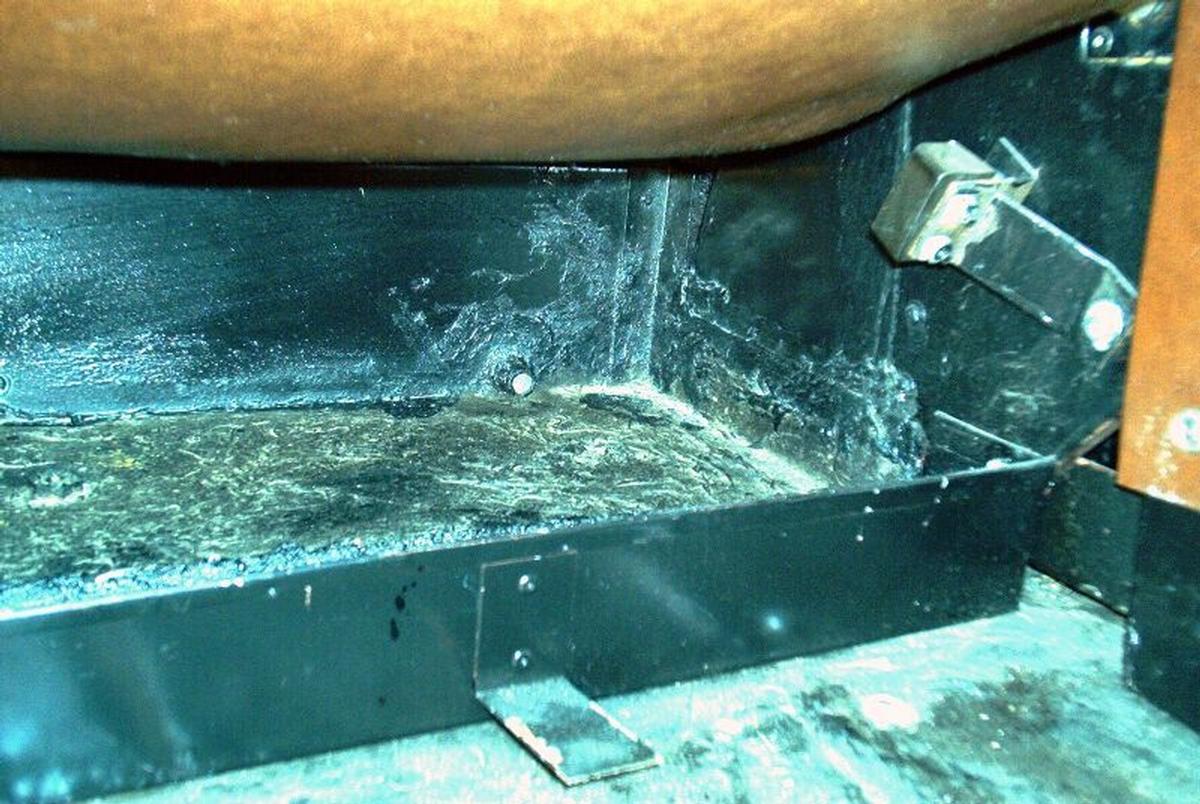

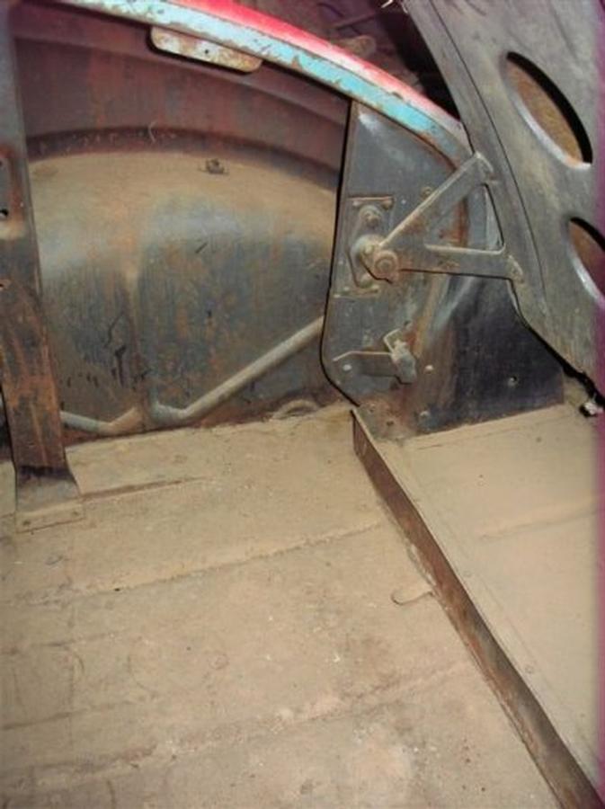

The drain hoses are for cars with a trunk lid only. The rumble seat area has a sheet metal piece across the rear in front of the rumble seat hinges that channels water to the holes in the rear area where the hoses would go through the floor for a car with a trunk.

Thank you, that’s the piece/feature my car is missing -- probably discarded during the first restoration back in the 1960s. Appreciate the photo too. Strangely I could not find this addressed anywhere on the internet -- like I’m the only one who ever questioned it. Thanks again.

This is what I have on my '35. It is a solid pan on all sides.
