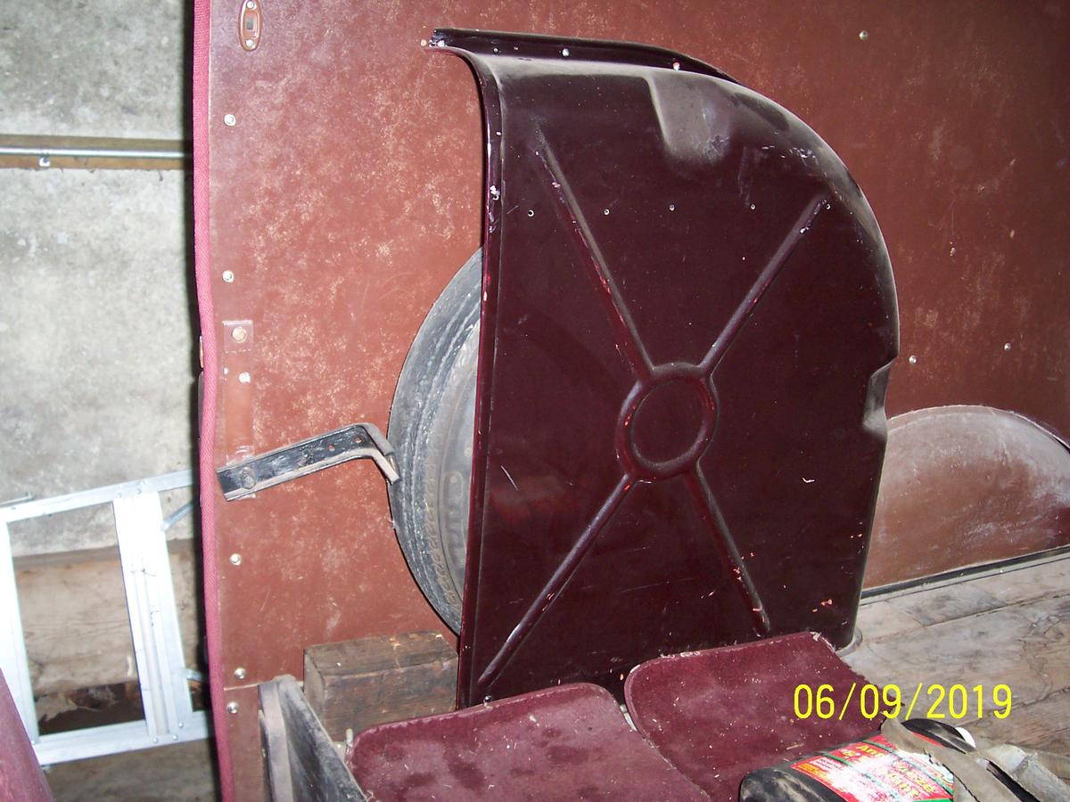

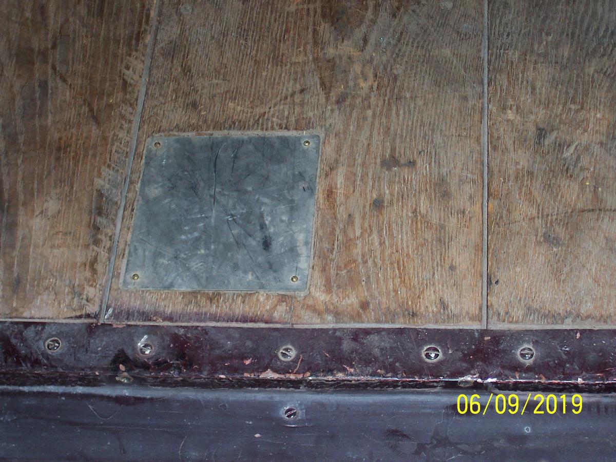

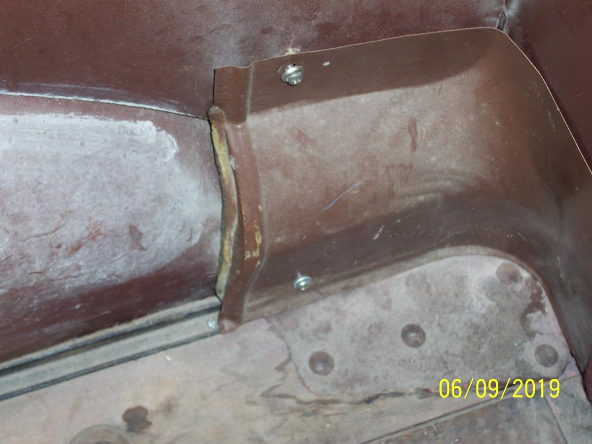

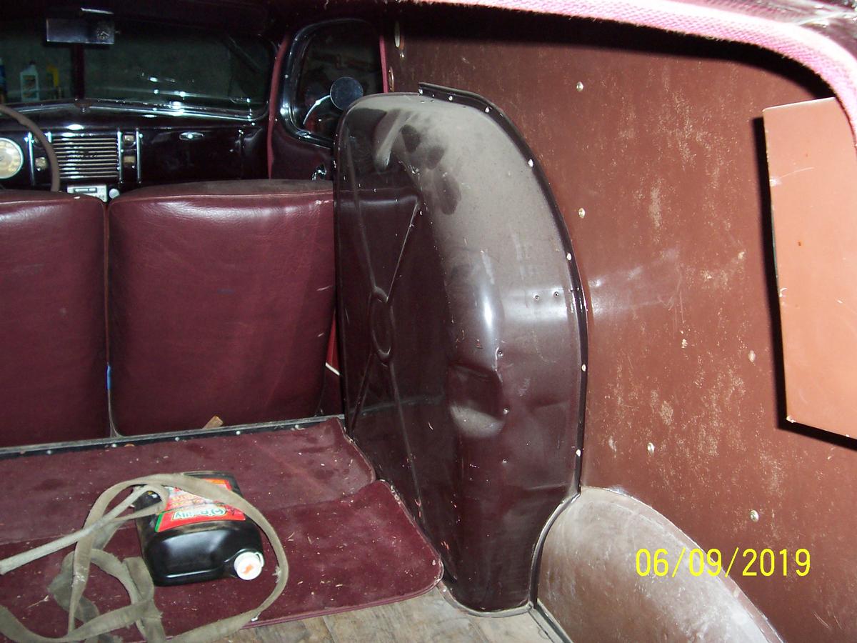

Here are some pics of my 37 delivery. They show the interior spare tire cover (a spare could also be located on the rear door), the covers where the floor is cut thin, and the cover for the gas gauge and the right rear corner

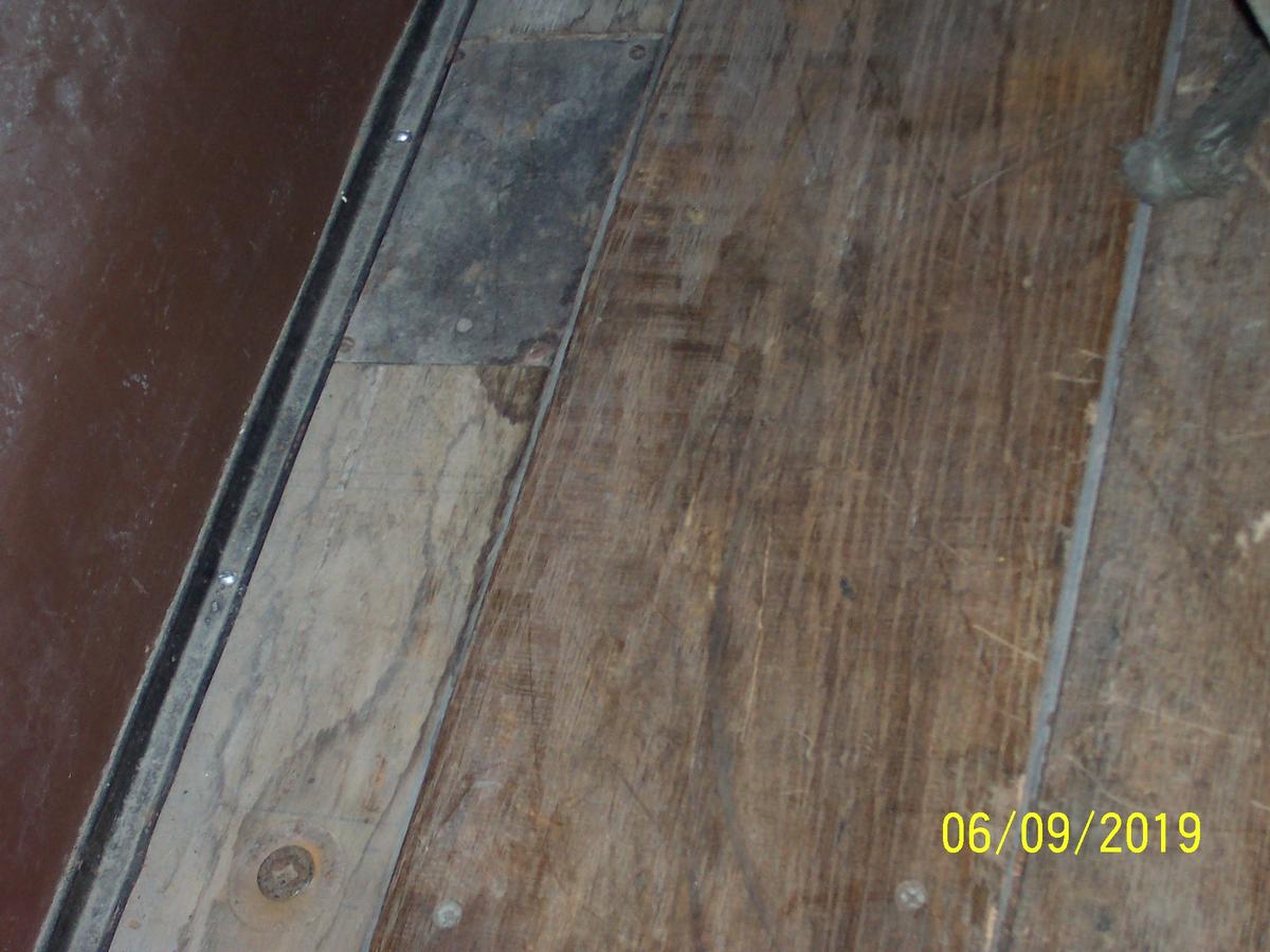

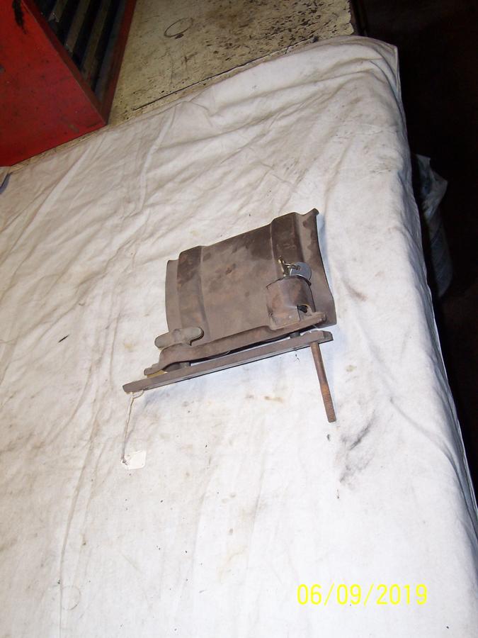

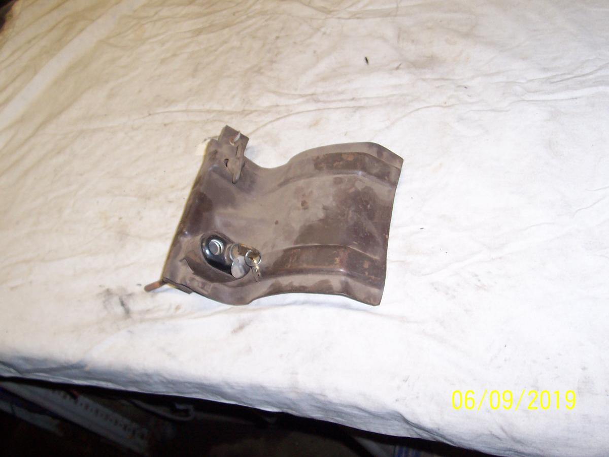

These show the bracket on the left rear, the front of the spare tire cover, the lock/holder of the spare tire which I have not mounted in the car and a picture of an actual rear showing the cloth headliner and the metal slide strips about 3/4 wide (I also did not install). Their is a picture of the bracket in the "Green Bible".

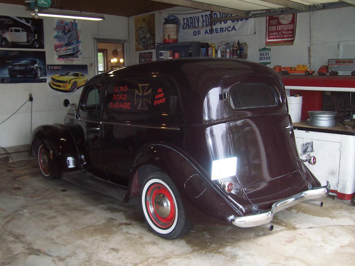

My car pic attached, it is coach maroon. Please forgive the NON original wheels. My wife just had to have something fancy looking.

Good choice of colors (mine is coach maroon also). It is more of a period hot rod with 59 AB and Merc crank
