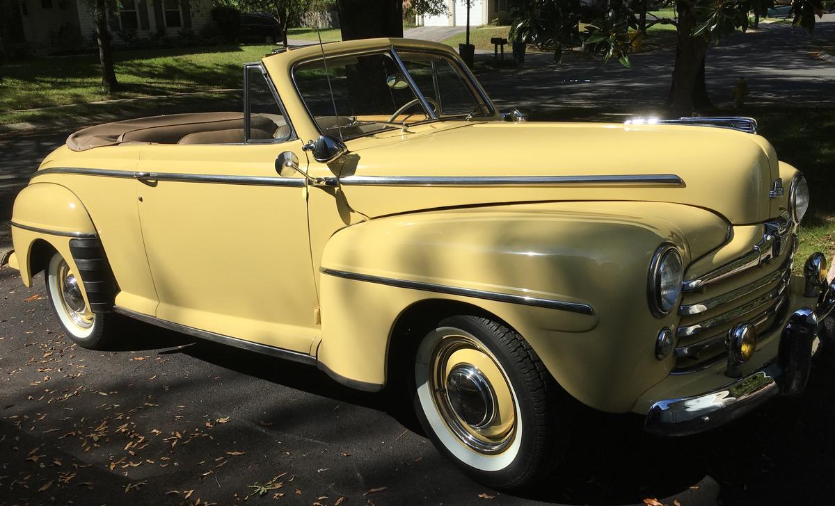

I have a dilemma that I need some help with. My '48 Convertible drives just fine at 50 to 55 mph, and can probably go all day. However, at 60 it is getting a irritated and at 65 it is down right out not happy. It will do 65, but I am pushing it and I do not want to. It would be very nice if the car cold be happy at 65 so that I could drive it on the highways near us (Annapolis/DC area) to go to some events and car shows a little further. My dilemma is do I go with a taller gear in the rear end, and sacrifice some low end performance, or do I pony up and commit to a Mitch*ll OD? A Columbia 2 Speed is out of the question due to cost and availability. I have read good things on the Mitch*lls, but being that the '48's never had OD offered on them, I am a bit skittish to heavily modify my drive train to accommodate a Mitch*ll. Therefore I am leaning more towards a a taller rear end gear... Nothing crazy, maybe just a 3.25 or a 3.54.. Thoughts?

For your vehicle, your area, and best all-around performance stay with (what is assumed here based on your description) your 3.78. 3.54s are not the best in hilly areas for stock flatheads but mid-western Flatlanders love them. I routinely drove my '47 with 3.78 up and down the east coast including your area and Appalachians and it worked fine - I just always avoided the interstates in favor of 2 lanes and 60 mph max (measured via GPS - speedometer read 56 mph). Quite frankly this era of cars were not designed to drive any faster than this and are not safe IMHO above 60 mph actual on stock suspensions especially in the event of any needed emergency maneuver at speed.
Slow down, smell the roses, be safer and find the best holes in the walls and true USofA on the 2 lanes and save yourself $$$'s in the process.
EDIT - If you ultimately feel the need to turn 1,850-2,100 rpm at 65 mph (again measured via GPS, not your speedometer) then I'd recommend the overdrive route over changing your rear gear. That 3.78 works great around (hilly) town with plenty torque and zip and as well gives you plenty of torque in the mountains (relatively speaking flathead-wise) - 3.54 not as much excepting for all flat-land. I do not think it even close to going out on a limb to say you will be quite sorely disappointed with a 3.25.

Thank you len47merc. I had completely not considered hills with a taller rear end, and we do have some good sized hills around my area. Thank you for pointing that out! You are also very correct about what is essentially a beefed up Model T suspension that is slung under my '48... Yes, it is probably best to leave the car the way Henry intended and just enjoy the slow lanes! Thank you also for the kind words on the car too!
