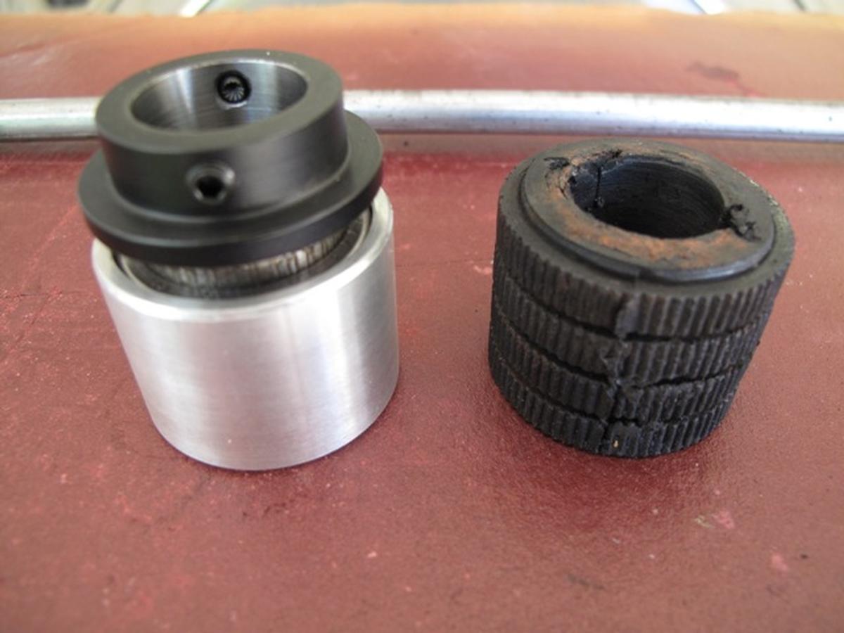

Another vote for Dan's bearing kit. He told me about three weeks ago that he was just starting a new run of them and will have them available very soon. Here is a picture of Dan's bearing on left compared to an original bushing. Ken

i ordered one from ken and had to modify my column, but it works fine
