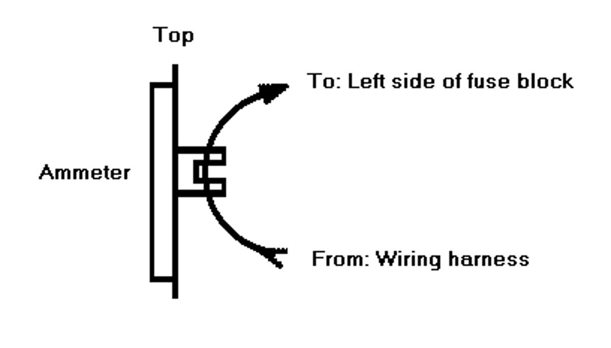

Why does my amp gauge read backwards. The wire just runs thru a loop on the back side, no connections. Jeff

The wire is running through the guage the wrong way. Or the battery could be hooked up backwards, should be pos. ground,

Here's a diagram of the correct flow.

Gentlemen, Thank you I will recheck this. Jefferey
