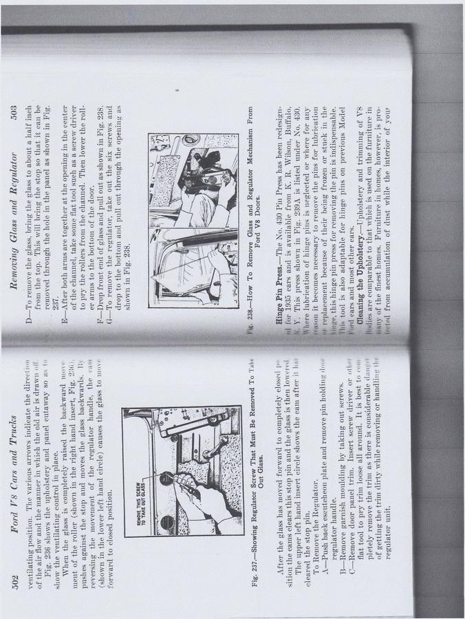

Maybe these will help:

Thanks for the info. However, the rear quarter window removal and installation is quite different than the door window. My problem is installing the quarter windows.
4dFordSC |
04-03-2019 @ 2:19 PM
Posts: 266
Sorry. Didn't realize the '38 2dr had rear quarter windows. My '40 doesn't.
