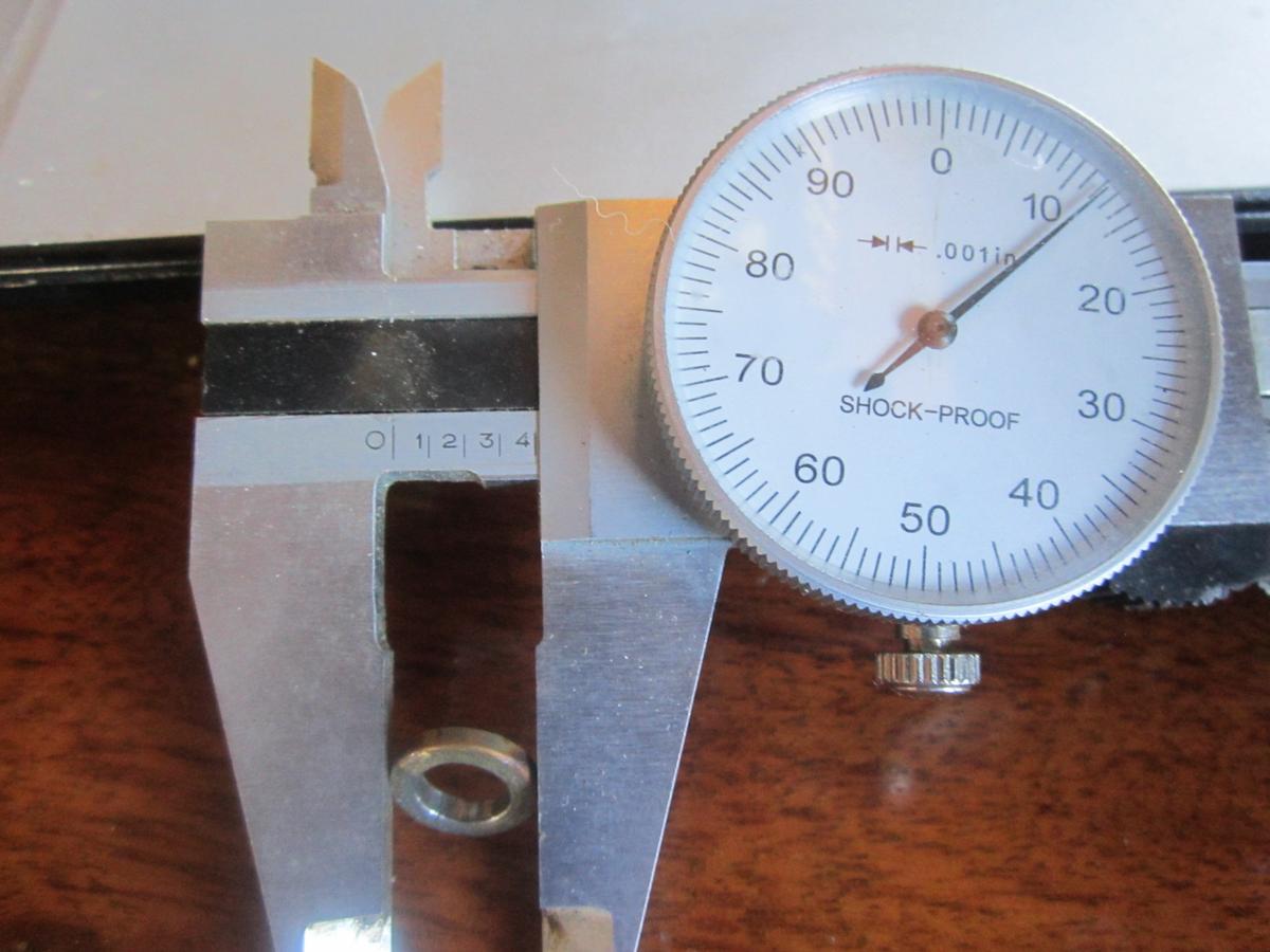

Good catch 40coupe. I mistook the spring for the roller. I hunted down an old original vent swing arm and found the original roller.
gregg
04-03-2019 @ 4:47 AM
Posts: 1801

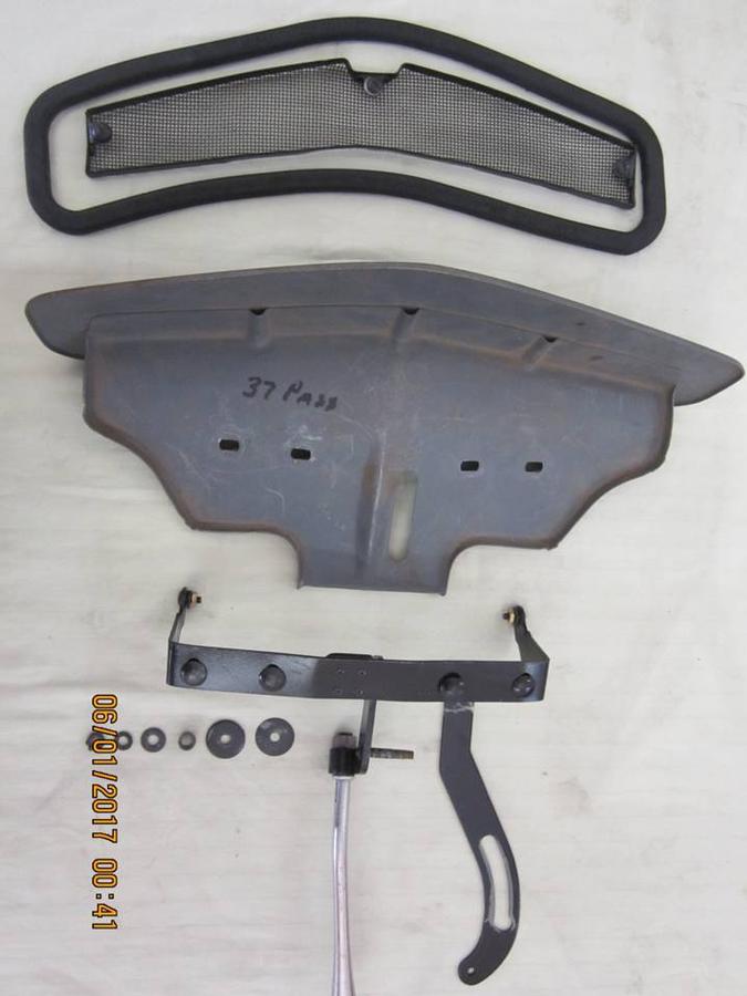

The roller (48-700615) missing from 37sedandeliverys photos fits over the threaded shaft (0.275"ID) and inside the cowl vent lever slot(0.400"OD) it is the same width as the lever (0.100). It allows smoother operation but usually is worn away from use and lack of any lubrication since it is made of brass.

You pulled another rabbit out of the hat! I see from the pictures I had an early cowl vent lever on my 37'. I'm contacting the guy who has a lever and see if his fills the bill. If I can't find the lever arm that's been sawed off, I'll get with my welding buddy maestro and we'll fabricate one. That operational cowl is VERY important here in Arizona. Your meticulousness and pictures are awesome. Thanks for the responses, everyone.

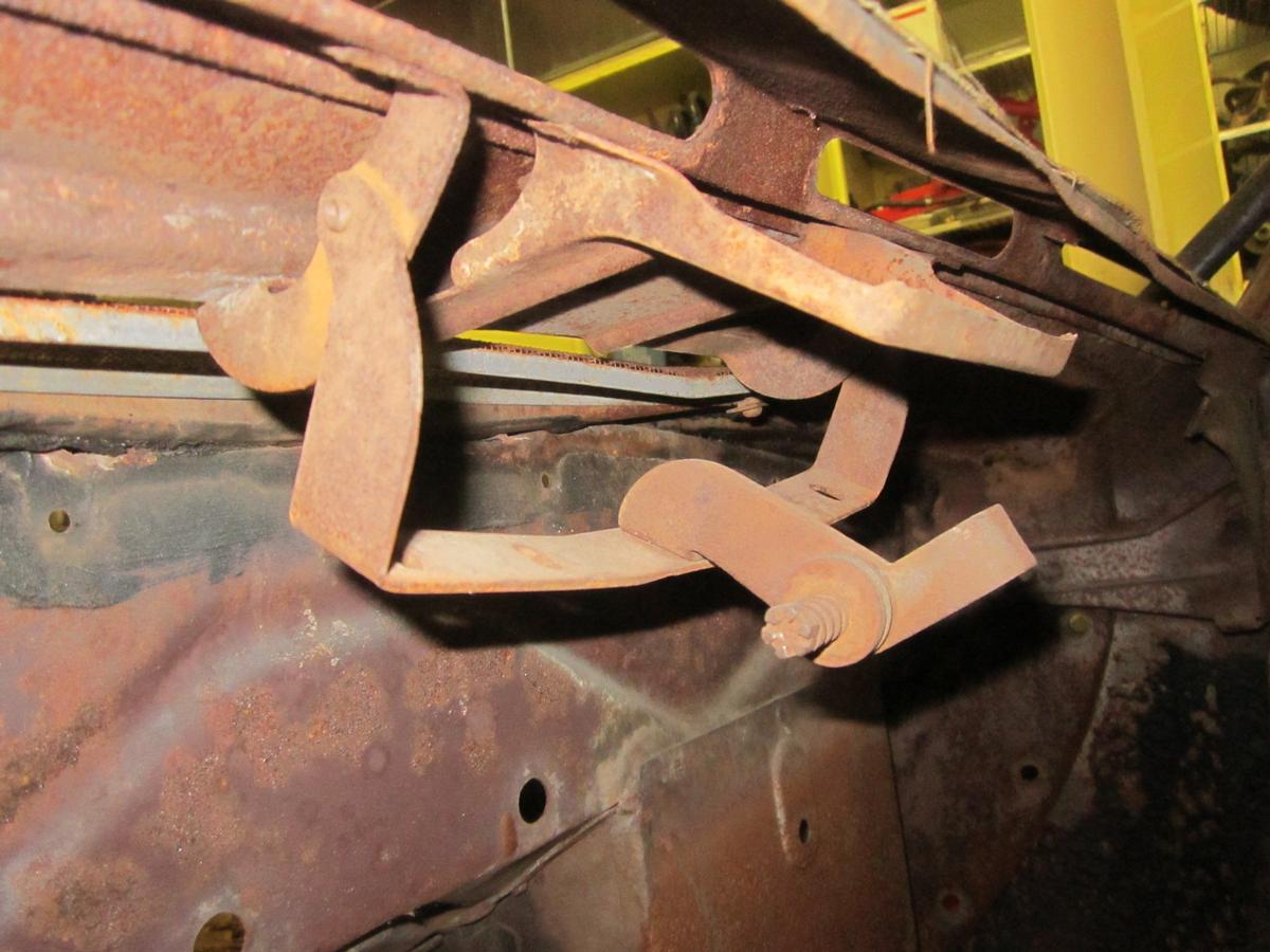

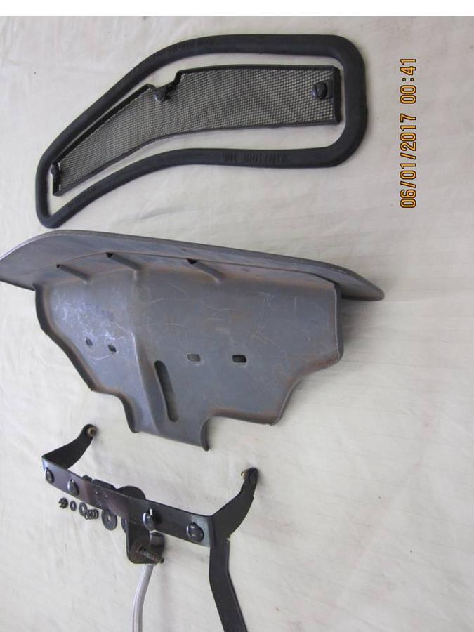

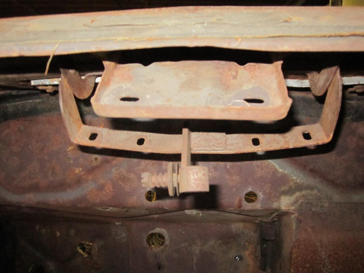

Here are some pics from my 37. I believe it to be all original parts. I removed it all, cleaned/primered and re-installed.

There were two versions of the '37 handle, the first being the same as the '33-'36 handle. Judging from the photos, your car originally had the early handle. There were other changes to the mechanism made at the same time so a '40 handle would not work in this instance.

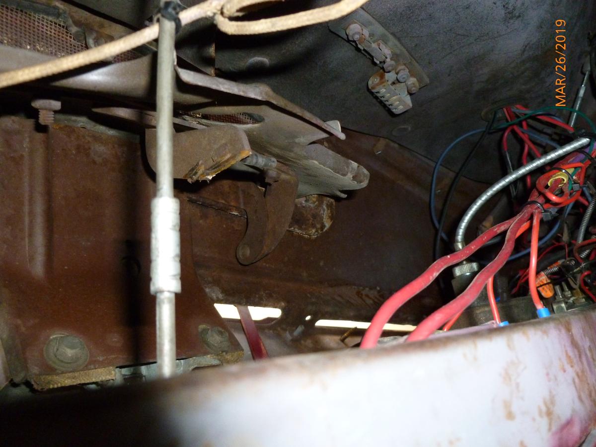

The handle was cut just in front of a pin coming out of the handle (about an inch long) with a hole drilled in it to probably put a cotter pin through. You can see the pin in the picture, and the hole. None of my books has a drawing of this part. I did have a gentleman contact me saying he had a handle but I am entirely in the dark about what I need. I wish Ford had made good drawings of the parts of their cars. It could turn out like a man having his arm severed above the elbow, and he gets his hand sewn back on without his forearm.
