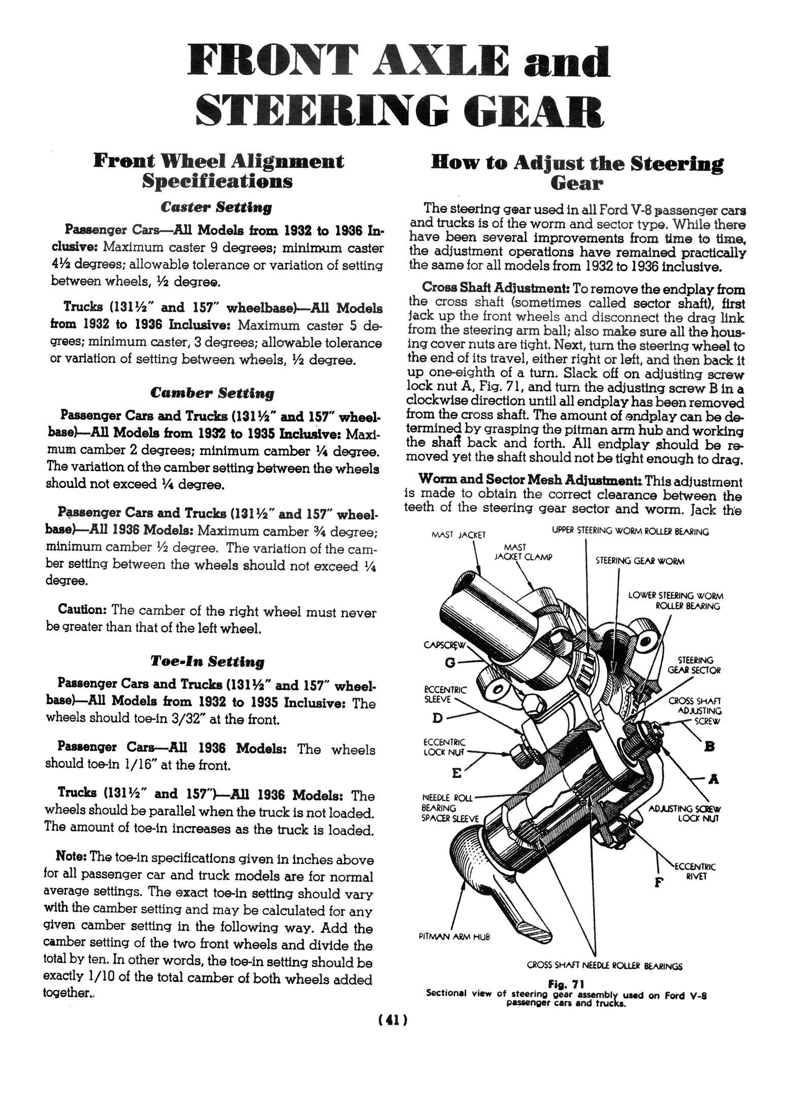

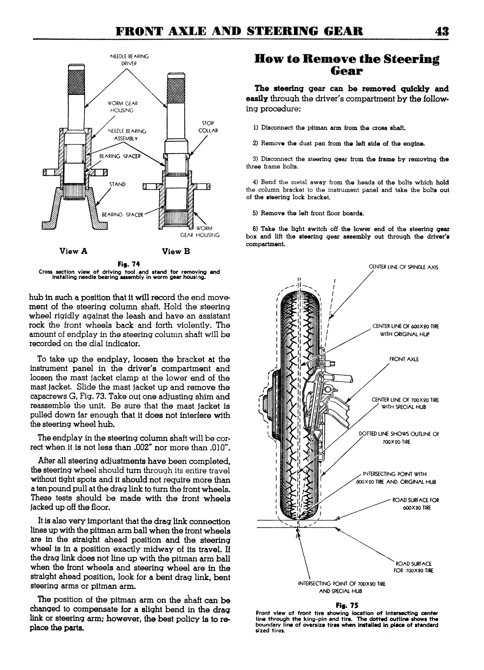

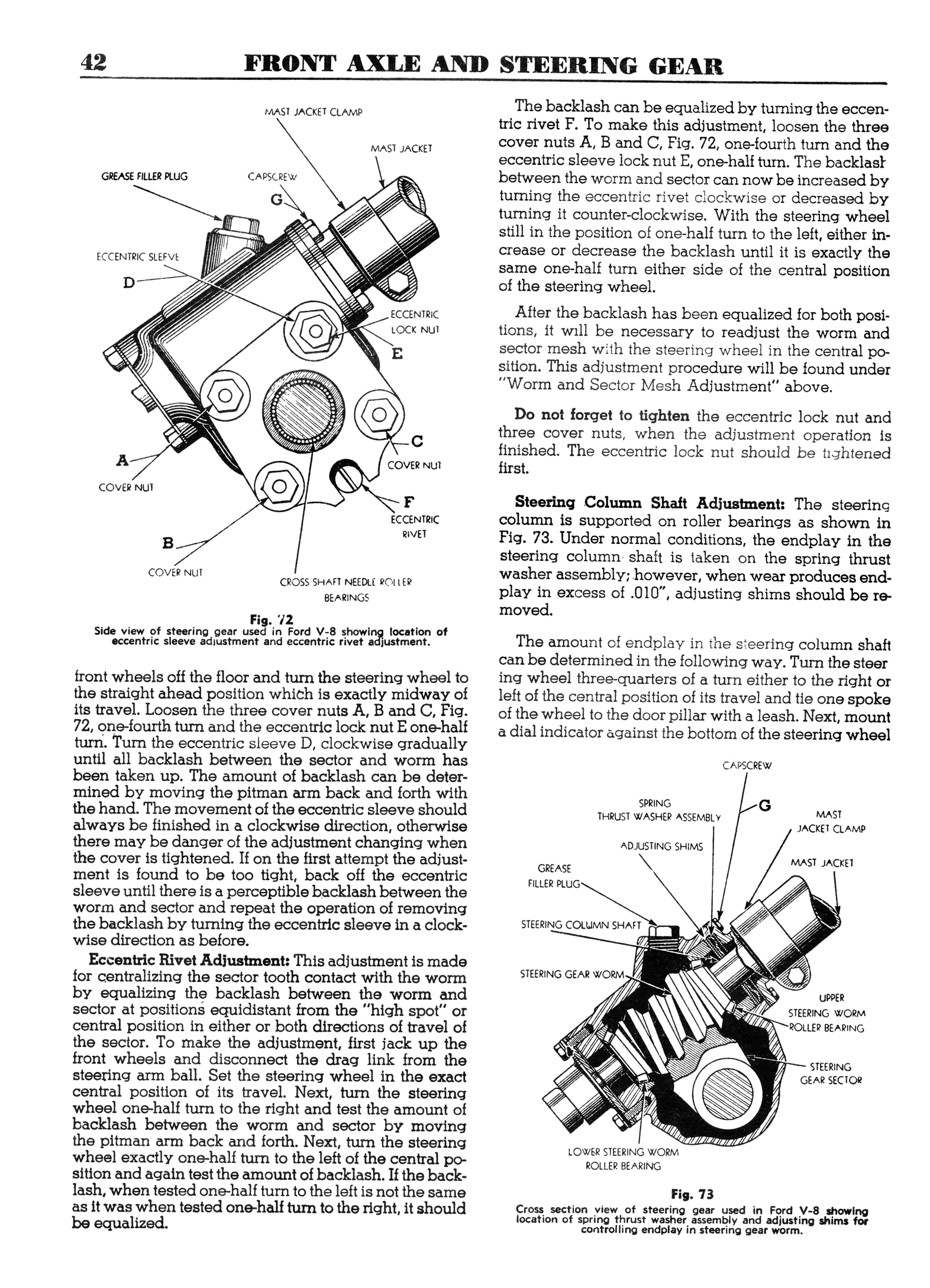

Pierre, Here are 3 pages from an old NAPA repair manual that might shed some light on your project.

Photo 02

Photo 03
