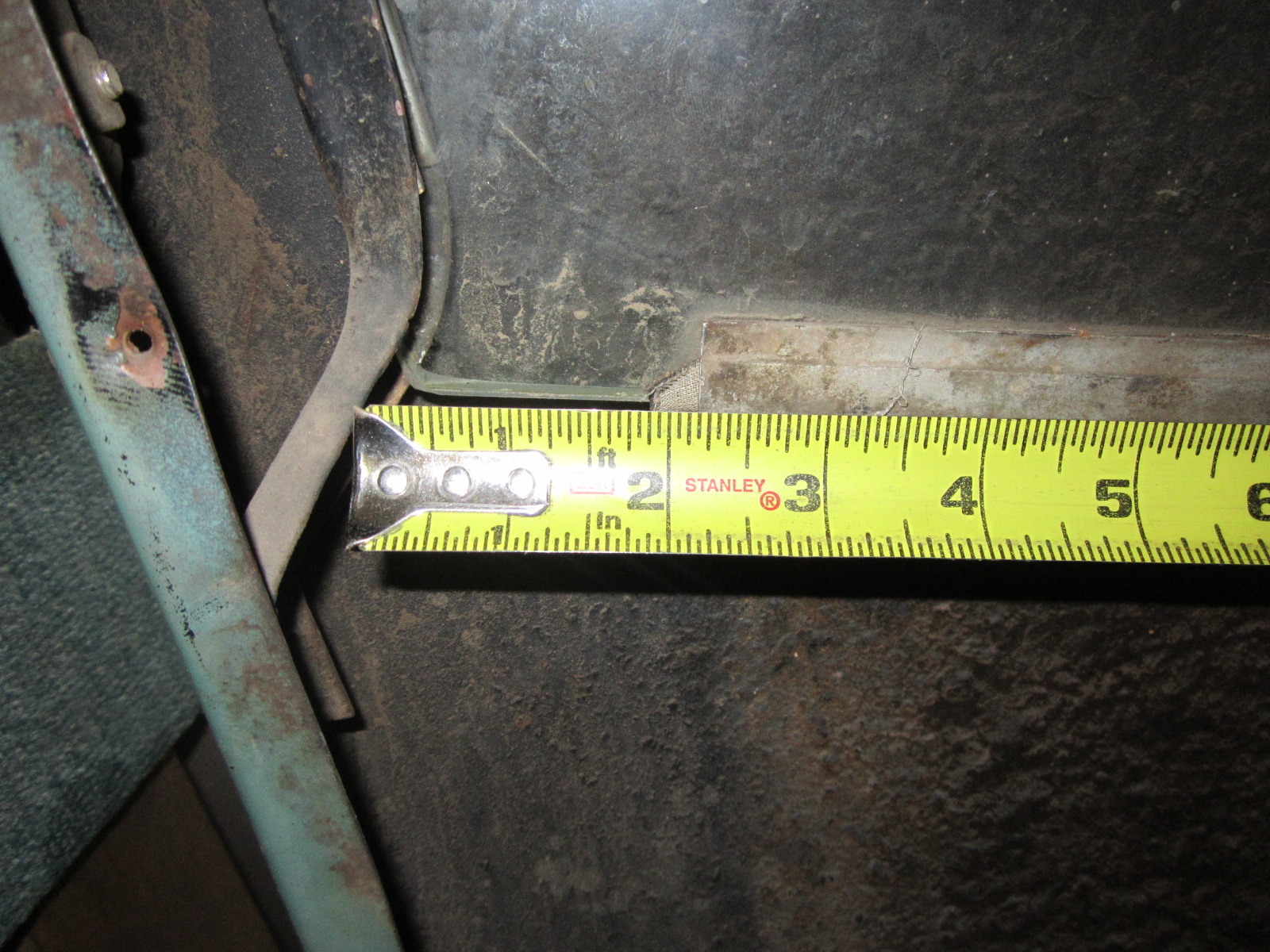

Meantime, the attached pics are from my 37 Tudor driver's side window. They should help. If you need more, just let me know.

alas, I re-started the webpage and it now allows me to attach files!
1937sedandelivery
03-14-2019 @ 9:41 PM
Posts: 501
Joined: Jul 2014
another pic
1937sedandelivery
03-14-2019 @ 9:42 PM
Posts: 501
Joined: Jul 2014
another pic
1937sedandelivery
Posts: 501
Joined: Jul 2014
last pic

Thank you for taking the time to take those pictures for me. I appreciate it. But my problem is with the rear quarter windows, which have a different regulator and bottom glass channel. Do you think you would be able to get good pics like that of one of your rear windows? That would really help me. Thanks.
