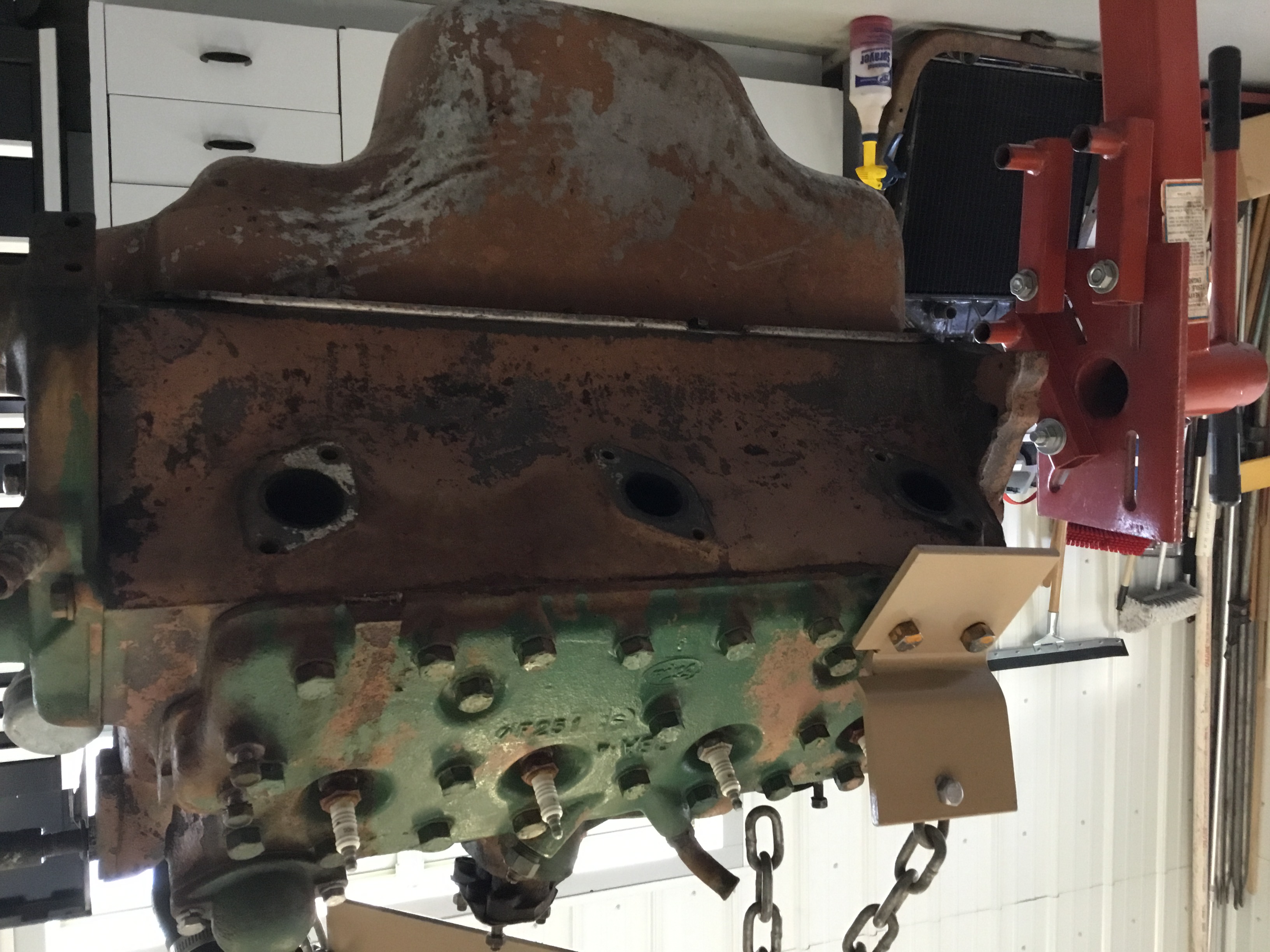

My flatheads are all earlier, with the integral bell housing,,nevertheless this will work. I built my own, works great.
Take a plate of 1/4 ", shape it to fit on side over ex. Drill holes matching the ex, and weld it to a tube that fit my particular engine stand. Works great.
