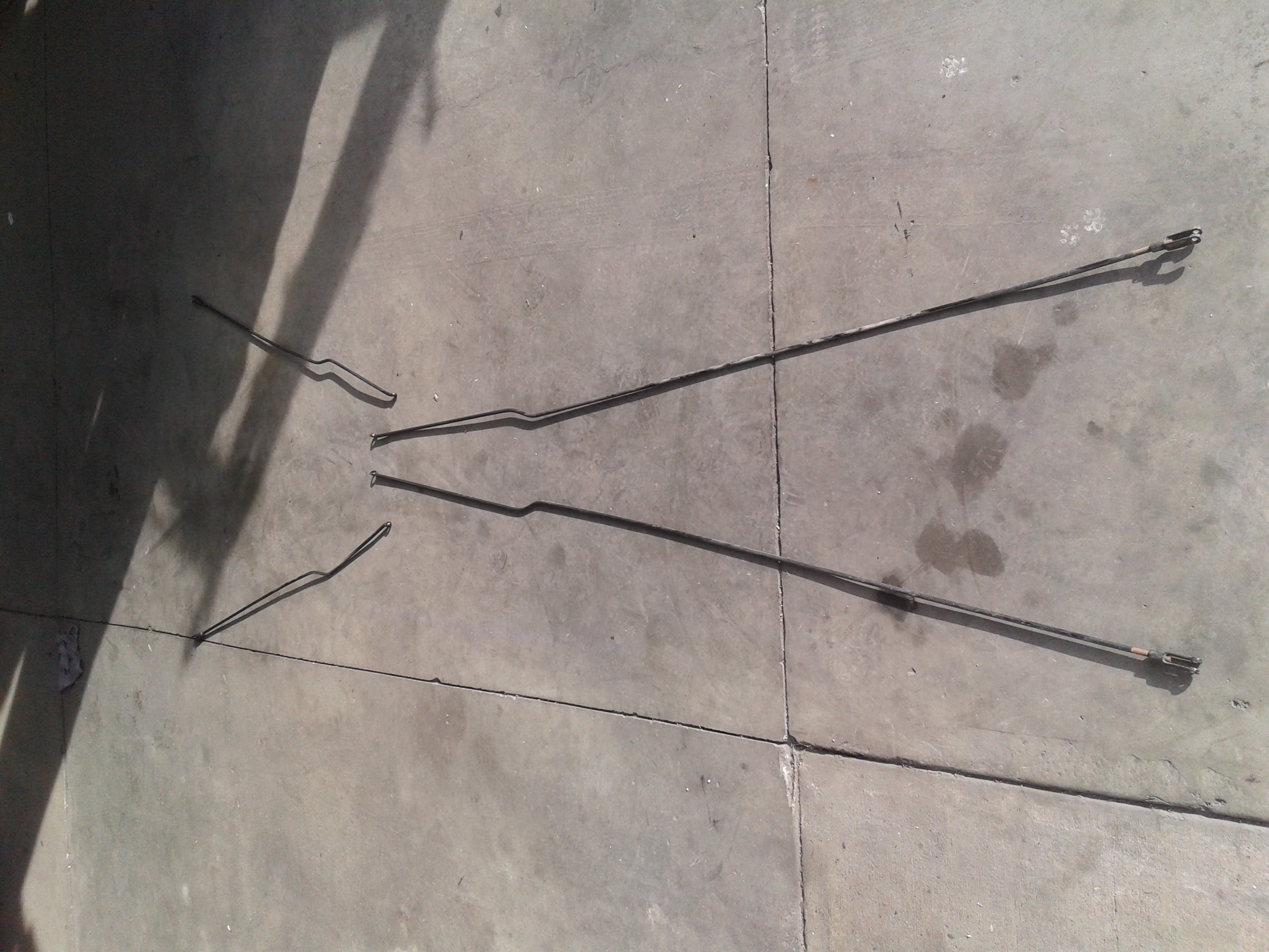

Having the brakes looked at on the 36 and it has some retrofit adjusting hardware as well as these brake rods with a bend in them.
The shop, has never seen anything like it and classics are their specialty.
Should I be concerned? I know original is best and this car was looking 100% until this.
Thanks for any info!

I don't know specifically about the '36 but a lot of incompetent mechanics thought you should bend the rods to adjust the brakes. I didn't work very well as the rods straightened out when you applied the brakes. How about a picture?

Bob, You'll never get those rods to perform correctly again. I'm afraid that even with careful straightening, they will have lost adjustment capability due to stretching. At best, they'll feel spongy, and without the ability to act in unison. Best to find new rods.

You should replace them for the reasons cited; your brake system is compromised by continuing to use them.

You may want to consider why they were bent in the first place. Was it to make the over all length shorter or to avoid something . Southside Obsolete may have NOS rods??

We recently replaced brake rods on a 35 fordor touring sedan that were bent just like your rods. Im sure they were bent that way by an inexperienced mechanic attempting to shorten the rods for brake adjustment. We corrected those and many other things on this car that were done incorrectly
