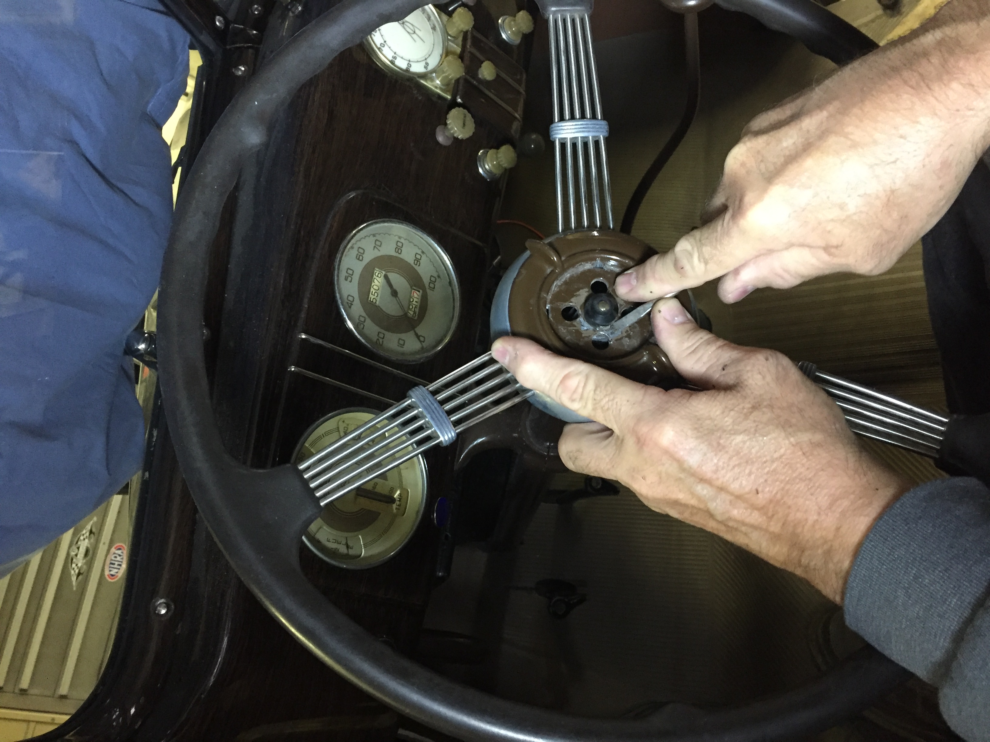

Problem solved. As it turn out the pervious owner had painted the area in the horn/headlight switch handle (see below photo). Once the paint was removed the horns was back in working order. Thanks to all of you for help and suggestions.

Jakes, Thank you for the feedback. It's good to know the problem was solved, and your picture sure tells the story!
