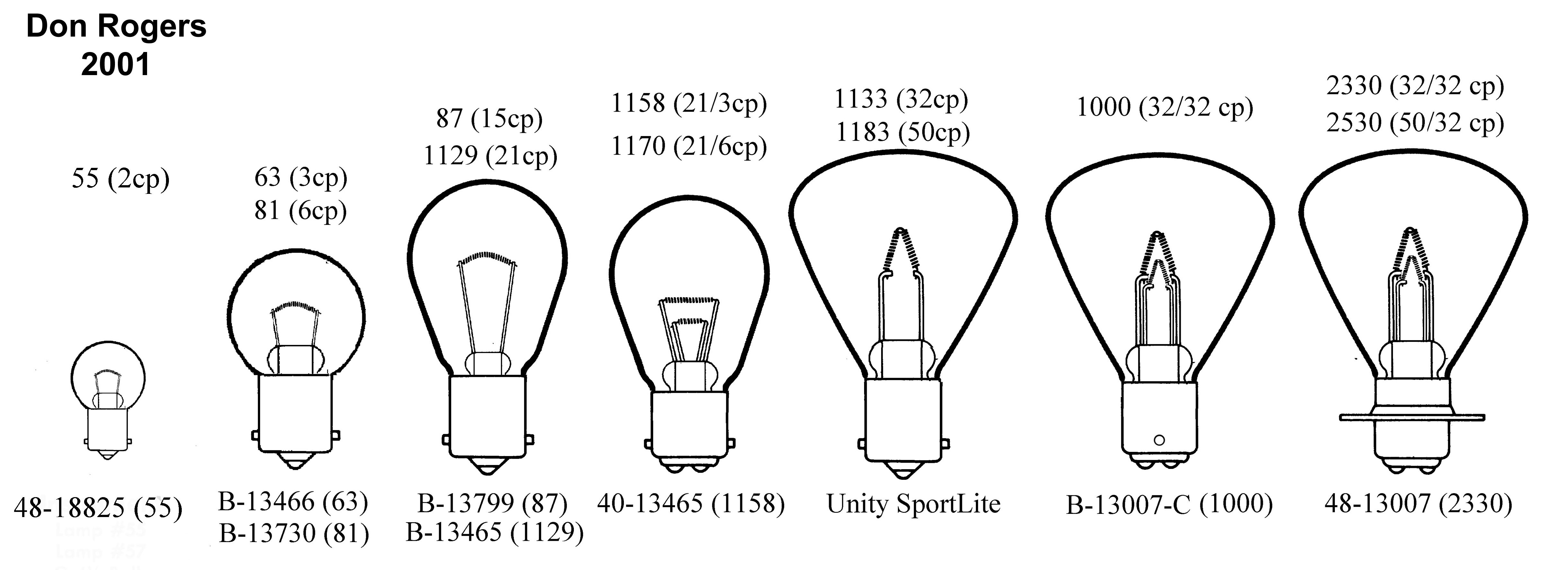

I have a 1941 Ford Super Deluxe Conv. Is there a list published anywhere showing the product numbers for the various bulbs used. ie. 1034, not the Ford number. It would be handy to have the bulb location as well.

C&G lists all of the bulbs on their website with the Mazda numbering system. (IE; taillight is 1154 or 1158) the 41 and later cars all use the 1154)

Try this link > https://www.earlyfordv8.org/forum/fileattachments/Untitled-11.jpg
