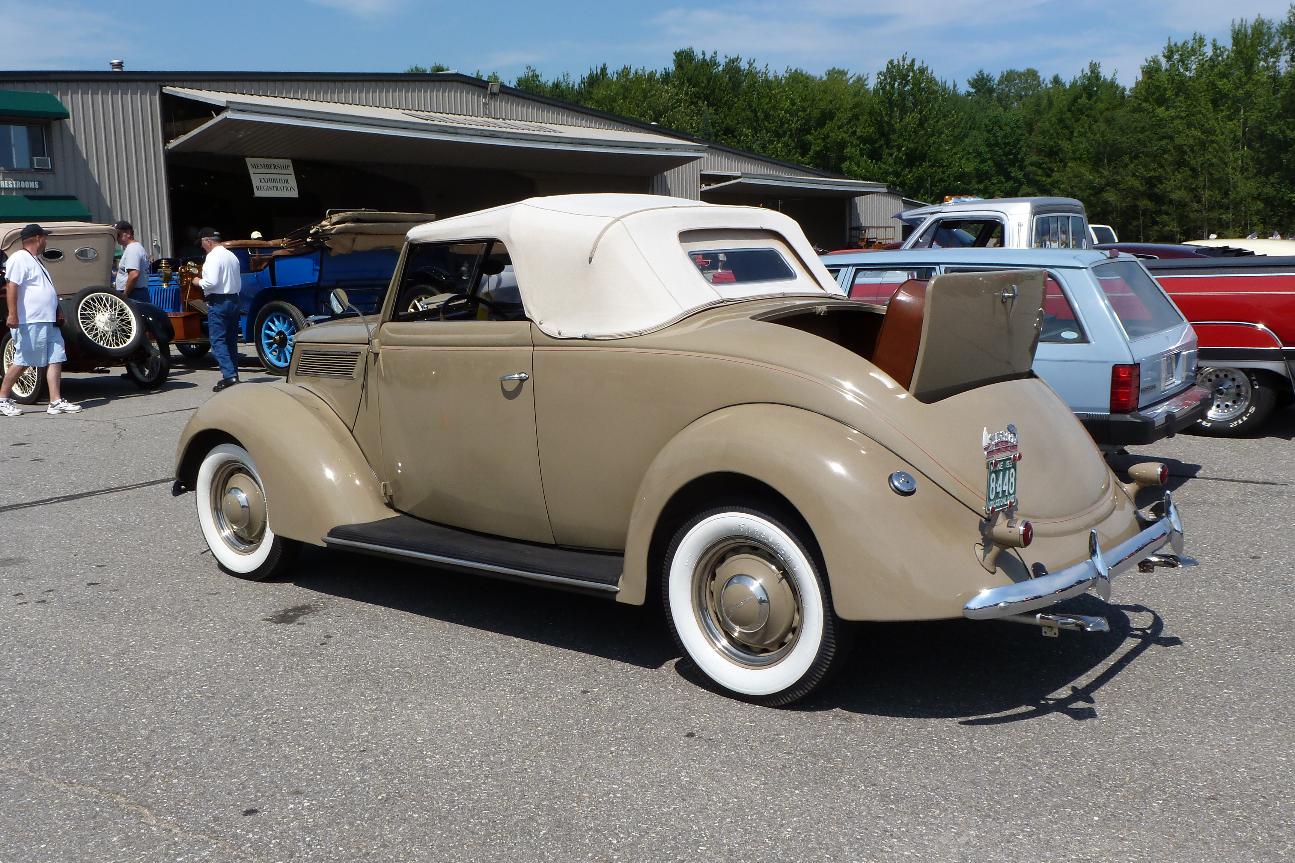

The front and rear bumpers are different,
the rear has more of a curve, then the front,
this is to match the curve in the BODY,
there are 2 different part numbers in the FORD GREEN BIBLE
I went with rechroming the ORIGINALS
doing the hard prep work might save you some $ ASK the chrome shop first, what need to be done,
