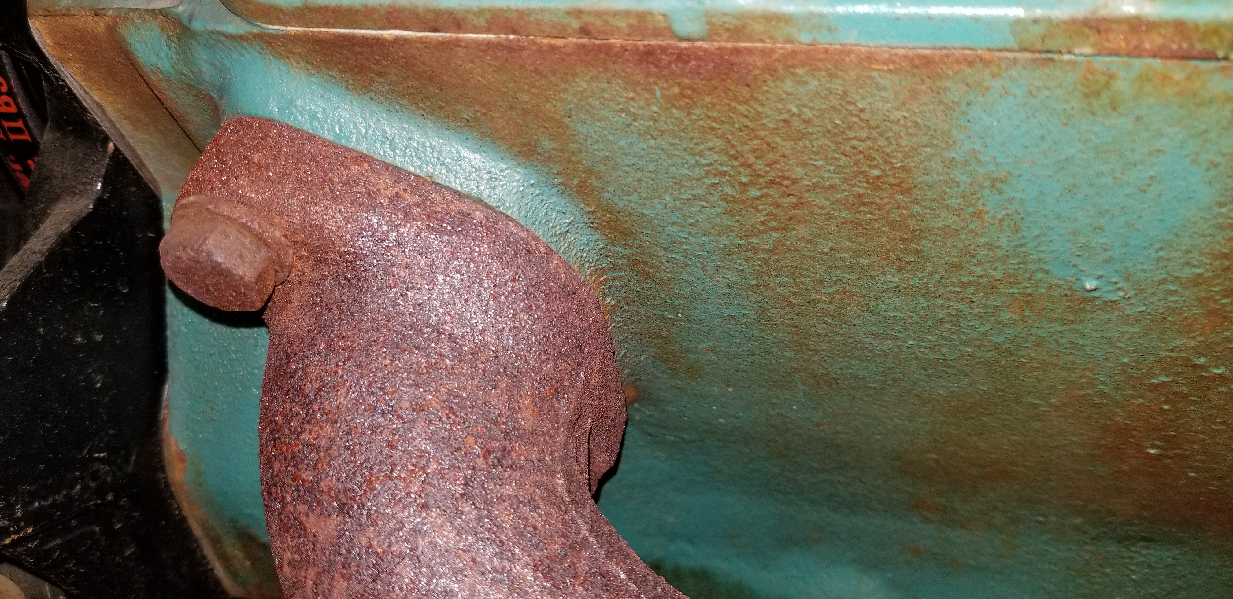

MG, it has taken me awhile to get out to the car. I've attached pic of the cylinder head (81A 6050). This picture does show the cylinder heads stamped 81A 6050. By this stamping the heads are from a '38. Additionally the block is stamped FZU (or 0)Z(or 7) 1508.

Mike, based on the pic in my reply to MG the block is flat where the intake manifold bolts onto block. Also in the attached pic the block is raised where the exhaust manifold bolt onto the block. So based on these pics I believe my engine is a '38.
