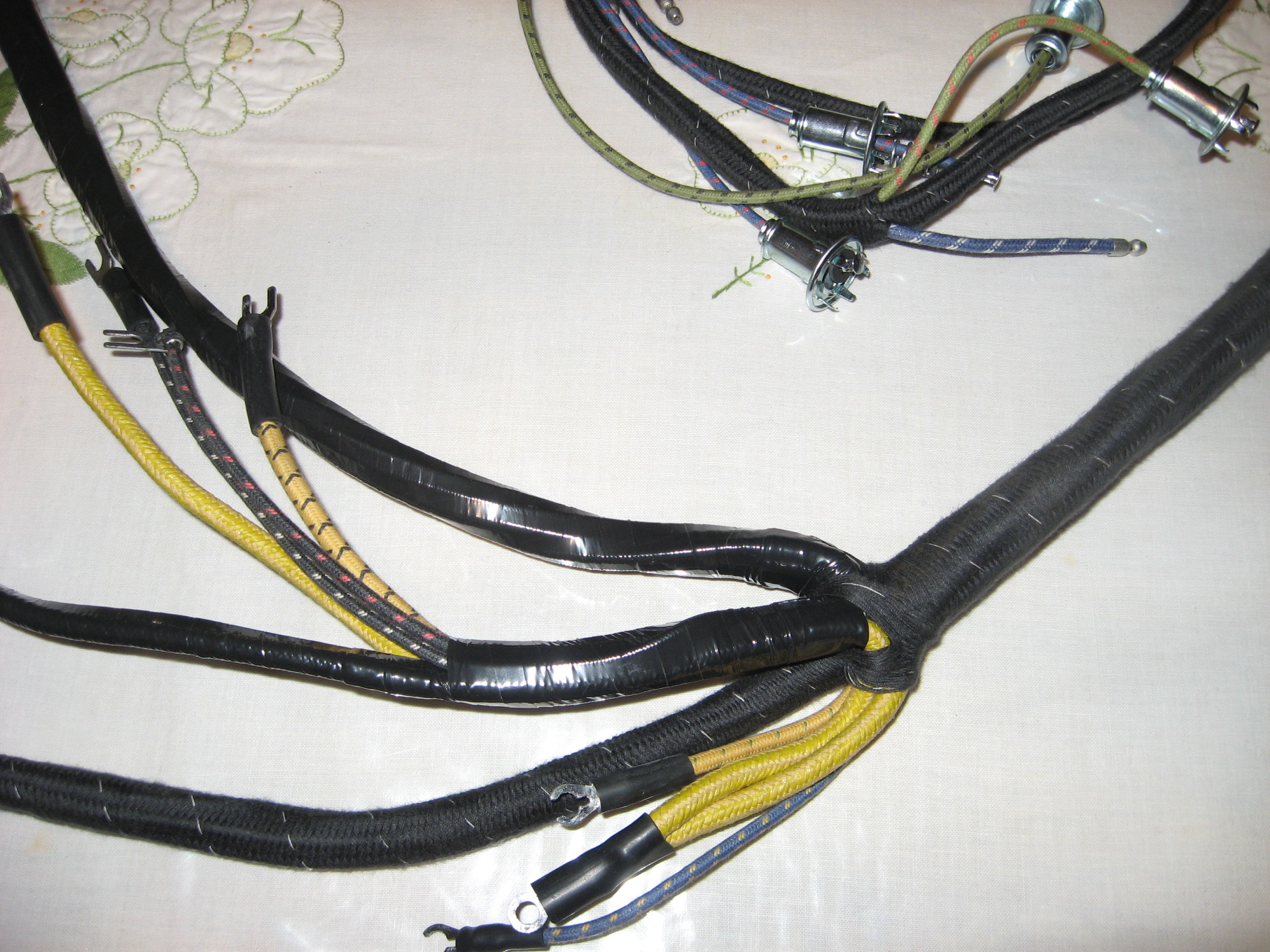

I am working on a 47 Sedan. I know I will need to rewire most of the car at some point. I just purchased (West coast supplier) the main dash harness planning to install over the Winter. What I received seems of good quality however the outer coverings over the wires are a mix of what looks like original woven cloth and vinyl? wrapping some other sections. Just does not seem right. If it was all vinyl I might not question it. I am trying to keep original in looks and function as best I can. My original harness is functioning but many sections of original jacket have been splices, repaired and wrapped over with vinyl tape. Should I return this to supplier and look for another supplier. If so, who makes the most correct harness for my 47. I did see Tyree and Narraganset recommended in other threads. Thank you - Bob

Thanks guys, Having the mix of vinyl and cloth puzzled me. My existing loom has cloth visible in some places. Previous owners have covered some of cloth with vinyl for repairs? I will check tomorrow about returning the harness. Hope I can. It is a fair amount of work to swap it out so I want it looking as correct as possible. Tom, I am a current EFV-8 member - with roster. I should have checked with John McDonald before ordering the harness. Thank you - Bob

Took a look at harness on ebay. Harness looks like mine with the cloth and vinyl mixed. The second pic shows the instruction sheet. That sheet looks identical to the one that came with mine. Makes me think they came from same vendor. I contacted my harness supplier and they graciously agreed on refund if I was not pleased with it. I was pleasantly surprised since they say no returns on electrical parts. Anyways, I will double check with our 46-47-48 advisor before sending it back. Thanks - Bob
