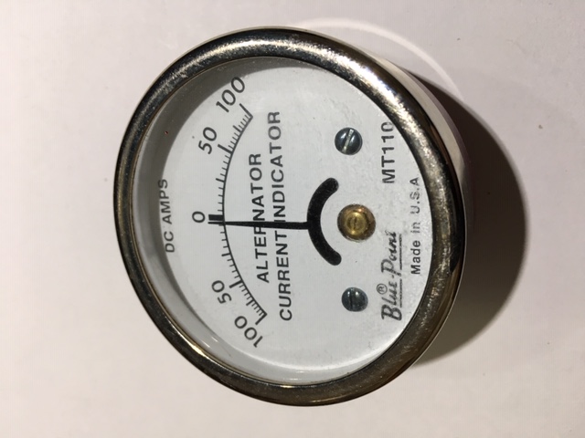

Many years ago I bought two Amp testers from Snap-On. An MT110 Alternator current meter and an MT109D starter motor current meter. These simply fit over the respective cable and read the current by induction. These are easy to use and don't require disconnecting anything. There are some listed on Ebay
