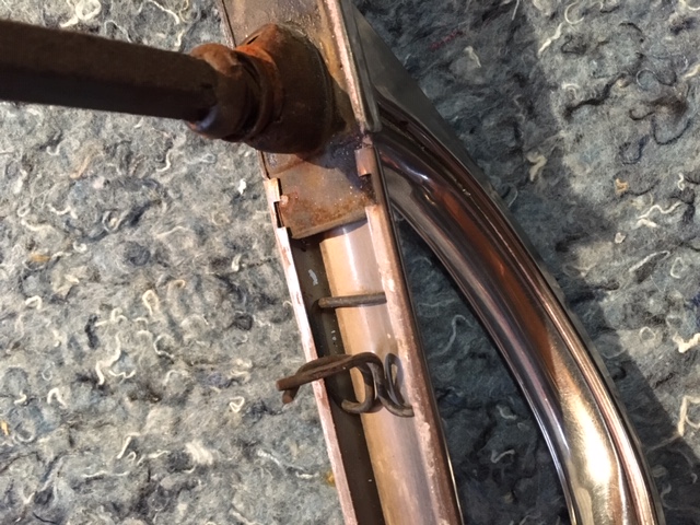

End of door trim slides over door handle body. Both need to come off at the same time. Remove the screw, then starting from the front edge of the door, use plastic trim removal tools and work back, carefully pulling the trim free as you work toward the handle.

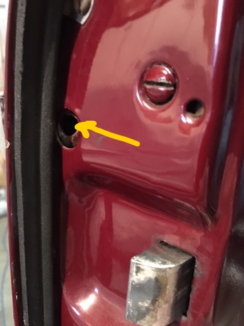

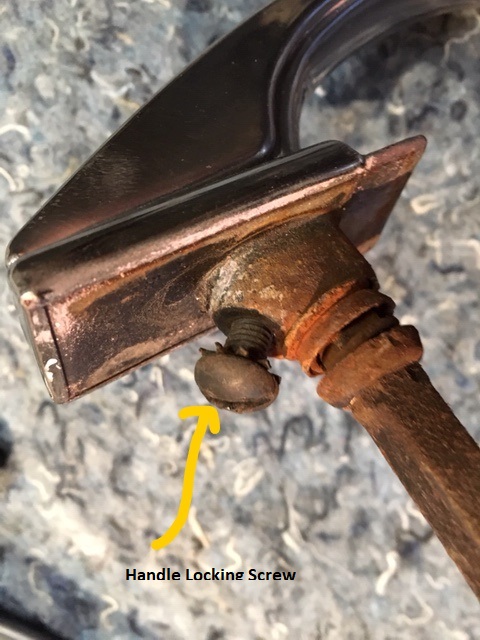

Mounting screw in handle

On a '46 the handle is retained by two methods. There is a set screw in the inner door jamb that must be removed. You can find the set screw by pulling back the weather strip near the area of the handle. Once that has been removed you need to slide the stainless door trim forward to clear the front edge of the handle trim. Then you need to tip the handle downward to the 4 o'clock position and pull outward. It should come out.

One end of the chrome strip on the door slides into the door handle. Could this be the problem?
