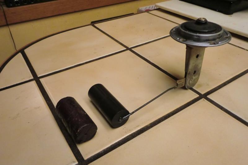

Had the same problem with my '37. I removed the sending unit and found that the float was made of cork and its protective coating was washed away due to today's alcohol gasoline - the cork was heavy because it had absorbed much gasoline. I replaced the cork float with a new fuel resistant float I purchased from MAC's. See > https://www.macsautoparts.com/ford_model_a/model-a-ford-gas-gauge-float-modern-neoprene-improved-compound.html - Buy two! I epoxied two of these together to make one float. See attached picture Ideally, you don't want to and should not have to replace the sending unit....

As MG mentioned, it could very well be just the float of the sending unit. They tend to get saturated and become heavier than normal, thus resulting in a premature "empty" condition. The float is easy to replace: - remove the access cover plate in the trunk - pull the entire sending unit out (have to remove a number of screws holding it in and the sending wire) - replace the float - re-install the unit voila, done! gregg

What makes you think you have to drain the tank in order to replace the sending unit? Just don't smoke while you're doing the job. If you decide to replace the original sending unit in your car without replacing the float first, please send the original sending unit to me - I'll pay the postage. I'm confident that there is nothing wrong with it. Forget about it if it's an after market sending unit and not an original....

The original cork float on my '47 OE sender unit arm also got saturated. I removed the sender from the tank and tested it outside the car by running jumper wires to it. It worked fine as the wire arm was raised and lowered. I bought a vinyl replacement float from Mid West and it snapped right onto my existing sender arm. It is a Dale Carpenter product. I didn't need to do this but the Sender can be disassembled and cleaned with electronic cleaner. The gauge and sender work great and are still original.
