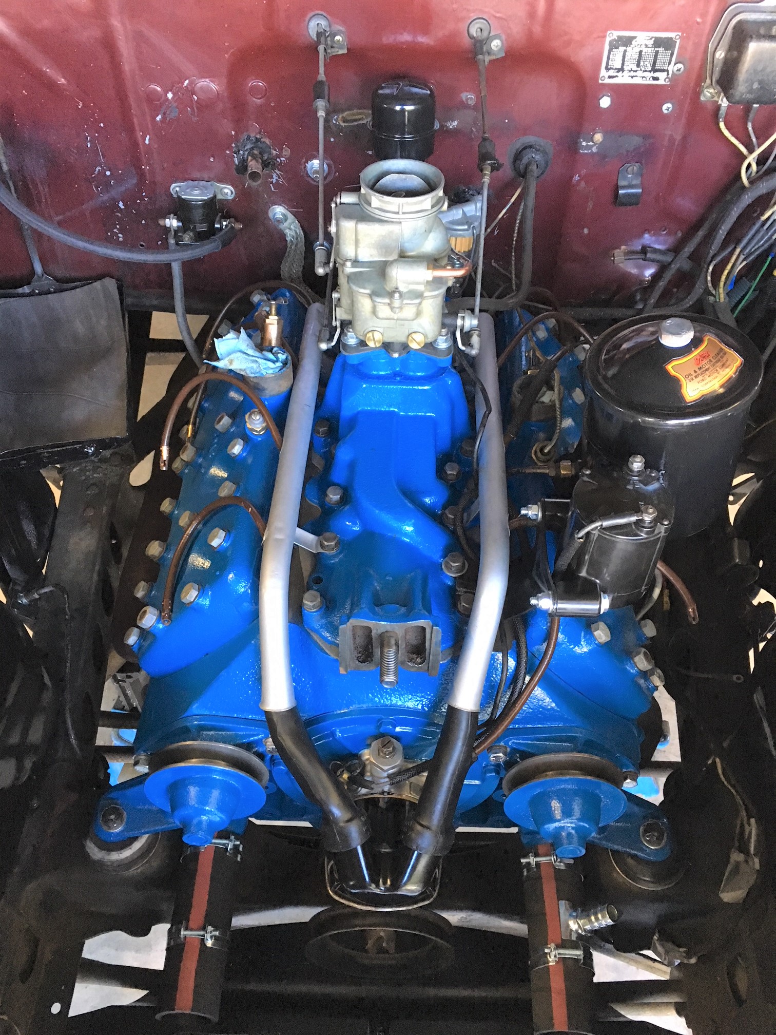

Here is where a picture will help.

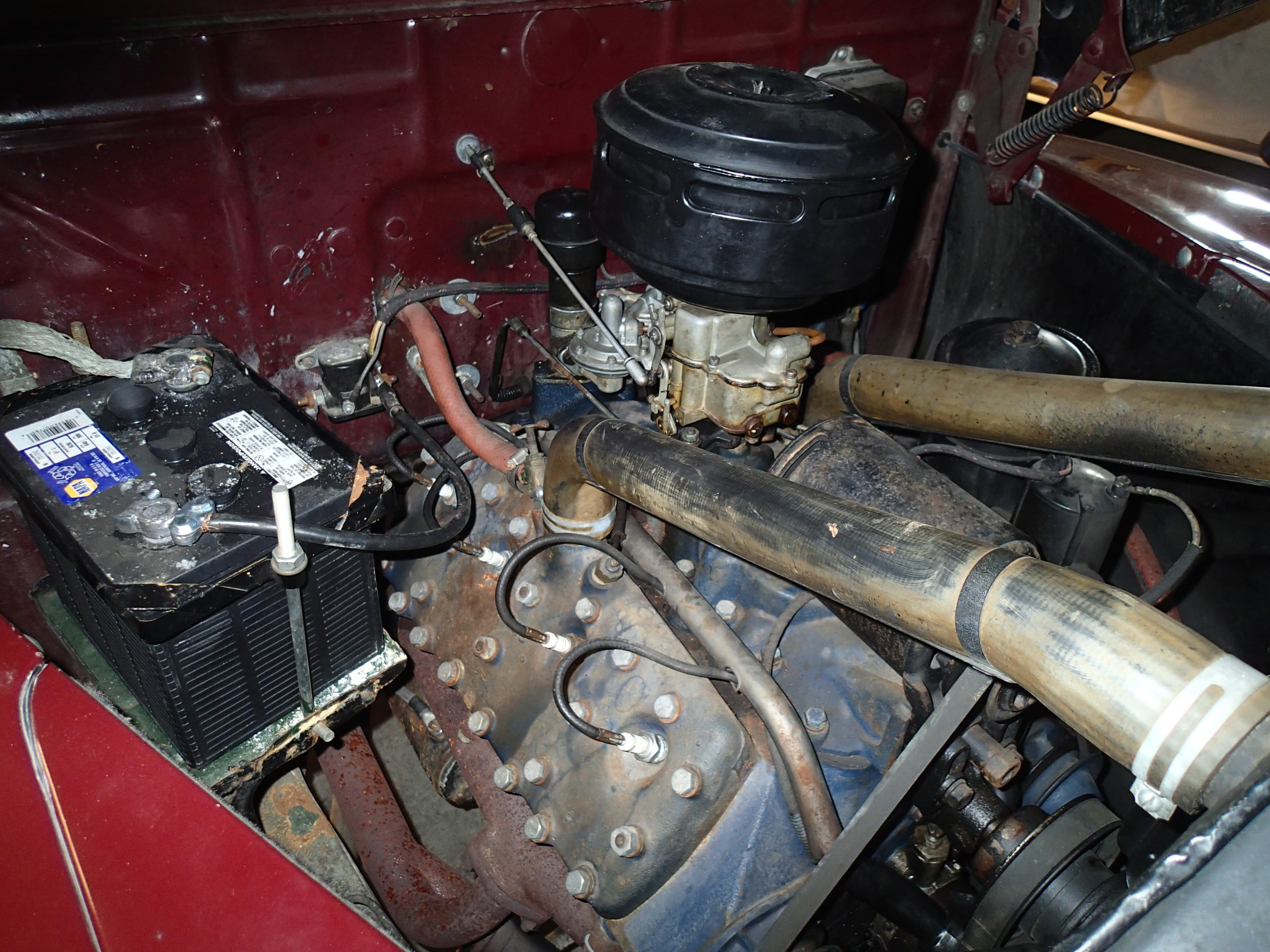

Here are a couple pictures of my '46 Super Deluxe Coupe that shows portions of the firewall.

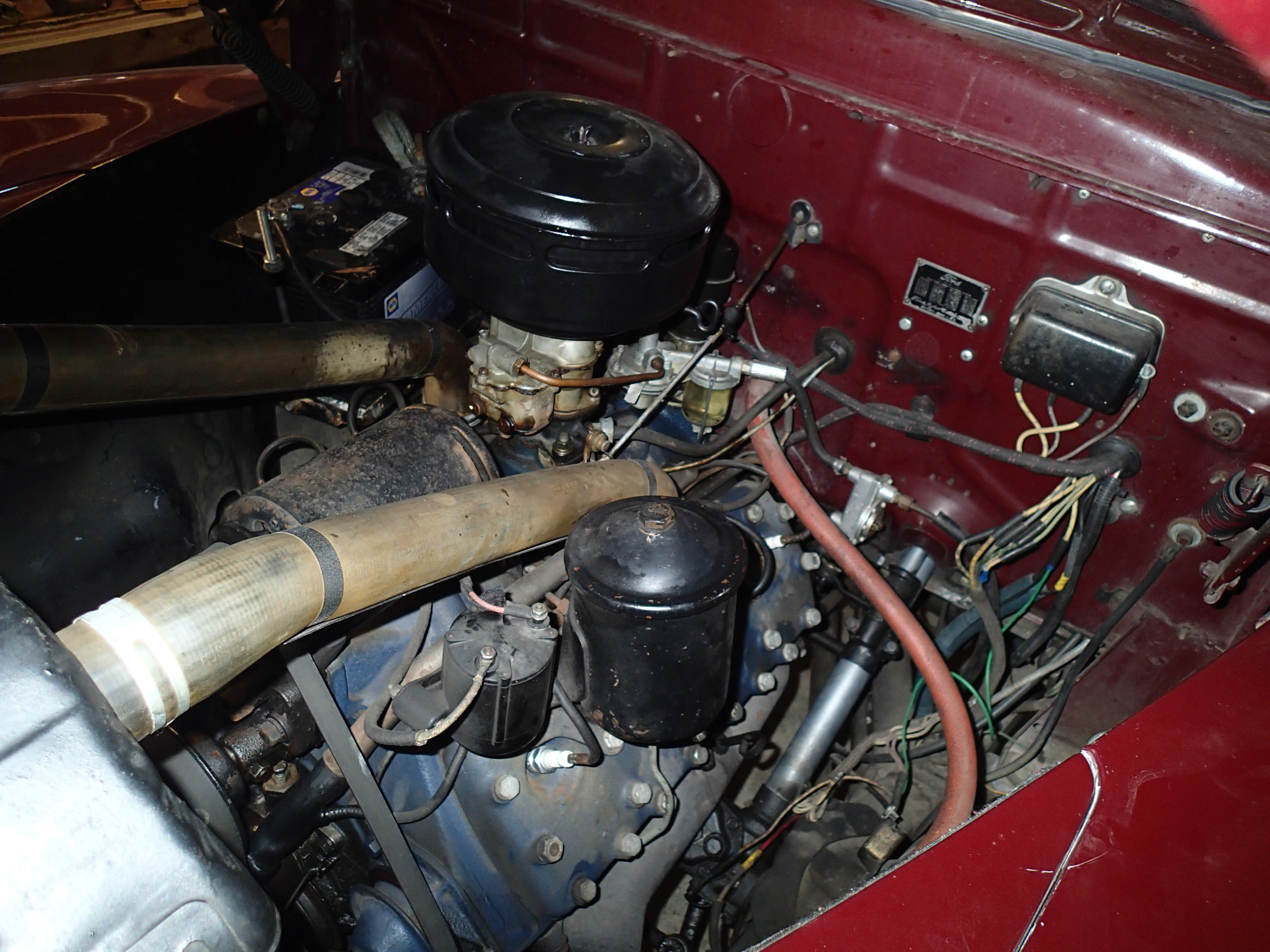

Had more pics, and don't know why they turn sideways.

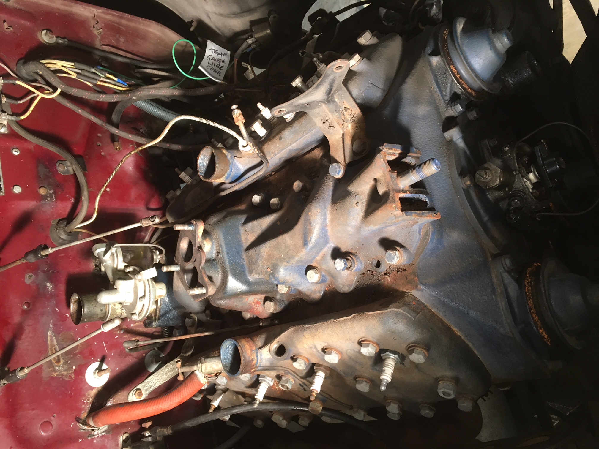

One more pic.

My eyes must be going south? I only see one heater hose and no hole
for the other one going to lower radiator hose?

In the second picture I see a return hose.

M. One heater hose you see on the pass side connects to the shutoff valve on the RH cylinder head. The return hose comes through the firewall just to the drivers side of the fuel pump stand and goes to the lower rad hose fitting. I have a sketch of the holes for the heater that is in my car, but I believe there were a few different type of heaters at the time, so the sketch may not match you unit. I can send the sketches if you need them.
