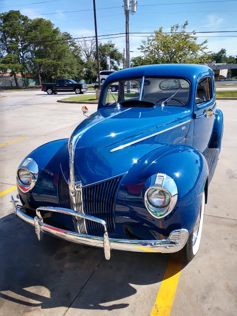

Working my way through the funky wiring put in place by unknown previous owners. My tail lights & brake lights work correctly, but headlights do not work. I did many searches on this web site and found references to "circuit breaker". Where is this breaker located on a 1940 2-door standard? There are several unidentified electrical gadgets strewn about under the dash. Yeah, I should rewire, but I only want to "fix" the headlights right now.
