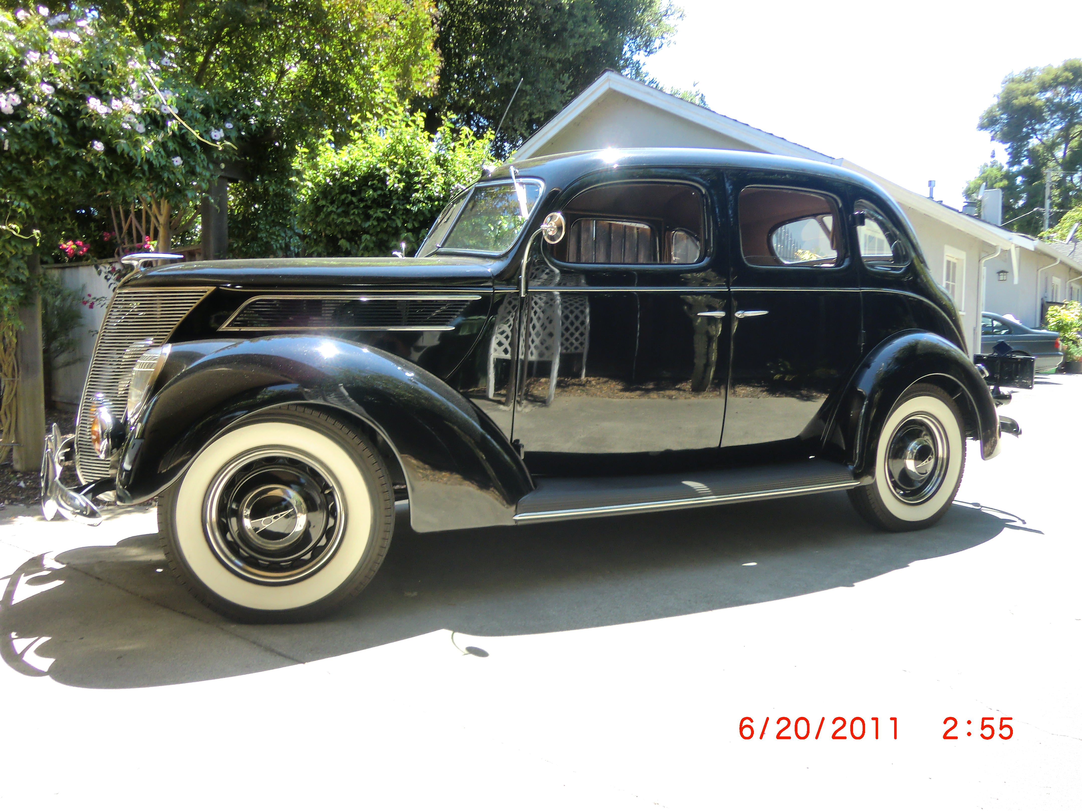

Beautiful car! Yours is a deluxe, whereas mine is a standard, But I like the lines and the styling, that is why I bought it. I don't know exactly what I will do with my car right now, but since I still can get around pretty well, it will get some attention. I understand about getting older. Seems if it doesn't hurt, it most likely doesn't work (personal body parts). What I like about retirement is that there is no pace set and I do what I like. Thanks for sharing the picture, Mike.

Mike - Up until October of last year I had a '37 Fordor that I owned since 1992. It was one of three old Fords I owned at that time. I too enjoyed working on it but with the back problems/pains I have I decided it was time to let it go. I really miss that car. A guy from Minnesota bought it and I'm pleased that he strives to preserve it as well. I have one car left of the three, a '34 that I can't get up the intestinal fortitude to part with. Attached is a picture of the '37 I had....

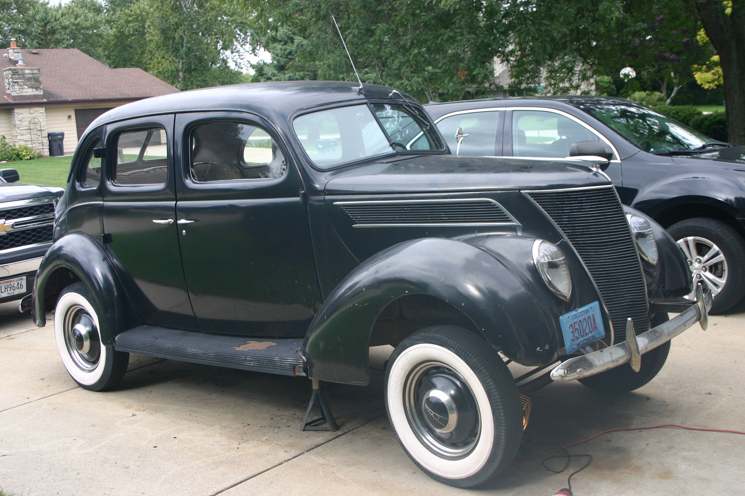

That's a very nice straight car and worth all of your efforts to preserve. You seem to be very capable....

Today, I finished my patch plate for the hacked up cross member. I got a nice tight fit and marked up everything to get the center bolt hole centered on the car. Then it was spot welded and the center rechecked prior to finish welding it in place. Looks good to me. I also tried out my bushing pusher on the wishbone. All looked good until the last 1/4". The bushing was moving into the wishbone with some resistance, but apparently a little to much resistance. The last push ballooned the bushing end and it was ruined. I had the wishbone clean and lubed, but.... I suppose that next I'll have to do some closer inspection and measuring. Maybe the interference fit is a little on the heavy side? I think that I can improve on my pusher a little also. I'll turn the adaptor so that it covers 1/4" of the end of the bushing so that ballooning stress is covered. Supposed to rain some more, so not sure how much more I can do. Here is a picture of my ride, she's a driver. Mike
