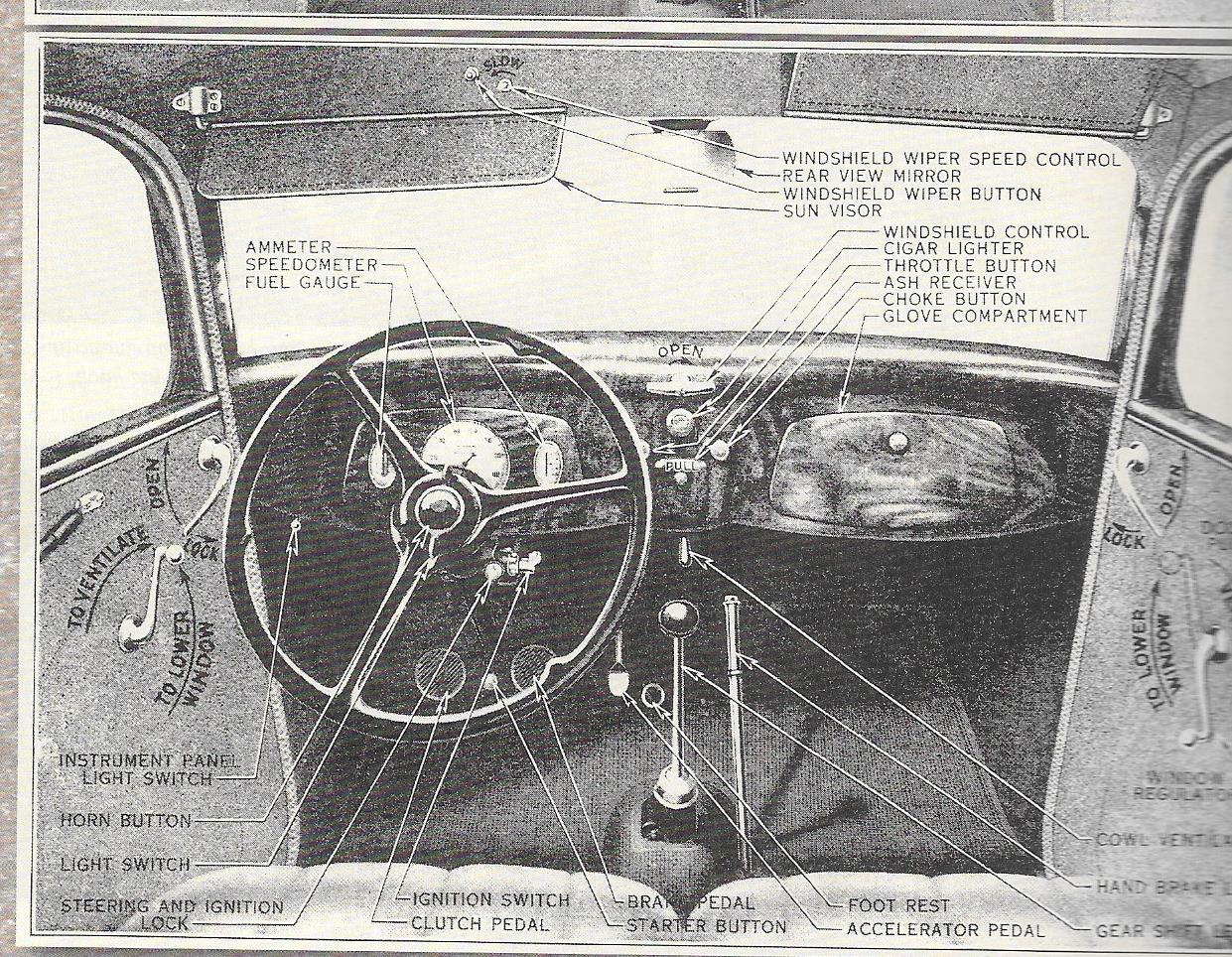

Here is the Deluxe door & lock. the Standard has a separate lever at the front of the doors. Push back to lock forward to unlock on Standard.
Apparently you have a mal-function, suggest you take it apart as suggested.

With respect, there was no difference between standard and deluxe door locks at any point in time during the '34 model year. There was a running change during the model year that relocated the door handle from the front of the doors (as shown in the photo above) to the upper center of the doors (on both standard and deluxe models). At the same time a separate short lever was added to actuate the lock function at the lower center of the front of the doors.

Thanks, I thought from that picture identified as a Deluxe 34 door panel that Deluxe may have been different than the Standard. The centered handle in all the 34's I ever had is a better reason for the separate lock handle that all of them had.
I think the forward door handle was a carryover from the 1933.
Your clarification clears it all up, Thanks.
